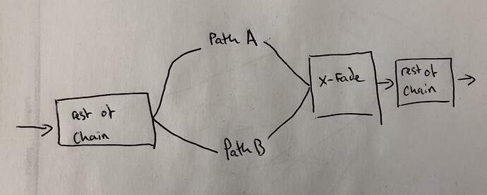

Hey!
Hope you don’t mind me chipping in
I don’t actually have a MOD device (yet) to see if this would work as expected but I think something like this could get close to the same effect, even if it works in a different way.
Path A: Drive 0, tiny gain 60%
Path B: Drive MAX, tiny gain 40%
Set up the two paths in parallel.
Use a cross-fader (eg Stereo X-Fade) to blend — using one knob — between Path A and B.
I imagine there would be some trade offs, especially in the middle, but maybe these can be minimised with careful use of the settings and fade shape.
Hopefully it:
  • is not impossible
  • is not too many compromises in sound
or it inspires a different solution which works better
Maybe someone with a device can let me know if this won’t work at all.
Let me know how you get on!
Edit: image for clarity
@danmh feel free to chip in as much as you want :slight_smile:
If I got it right, your idea is possible.
As long as you are trying to simply pair one physical actuator with a single parameter on your pedalboard, it will work.
