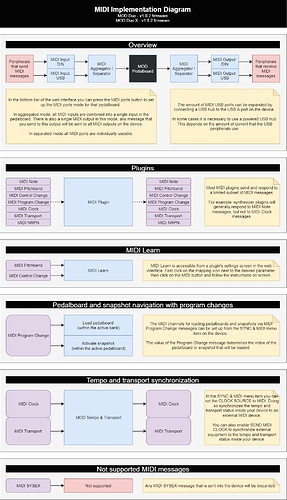

Check this diagram @jesse and @falkTX worked on. It describes the MIDI implementation in both MOD Duo and MOD Duo X.
We are publishing it on the wiki: MIDI Implementation Diagram - MOD Wiki
Nice! Thank you!
Would be great if sysex could at least bypass the host and go straight to the output. For the case when you need midi-thru.
I’ve actually have been looking at using sysex inside LV2, so you could ie. load or generate sysex for an external device. So I hope this part of the chart will be expanded in the future
Does this apply to the dwarf as well?
Yes. Currently, the MIDI implementation is the same on all the devices
