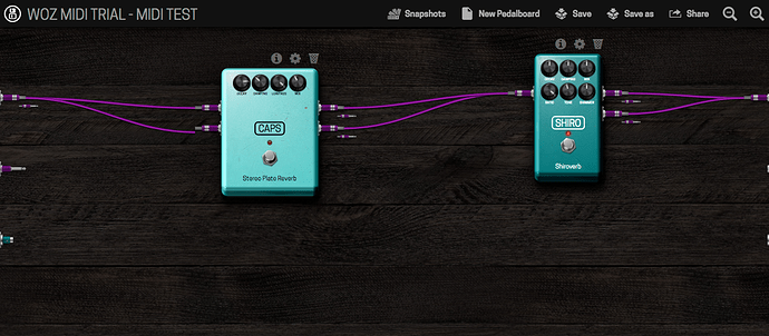

So say i had the pictured set up running into my amp fx loop. How can i turn the stereo plate reverb on and off via midi from my switcher/looper? Baring in mind its not accepting the midi learn thing.
You have to use CC instead of PC messages for MIDI learn. But you can save states of the pedalboard as snapshots and load them with PC messages AFAIK. Never did it myself.
Thanks, CCs fine i just don’t have any idea how to assign PC or CCs to anything inside mod duo.
