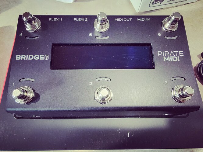

So I got a new footswitch in, but haven’t set anything up yet.
This looks like it will be pretty useful. But, until I get some time to install it, I won’t know if it is worth the kickstarter price I paid.
This model is the Bridge 6 by PirateMidi
Crikey Elk is it always Christmas at your house - new tech daily almost
Looks cool did you have to wait 2 years for it?

this footswitch looks cool. Prehaps better than the Morningstars Mc8. I’'l look at that more attentively.
But it’s not in stocj before May 2022
