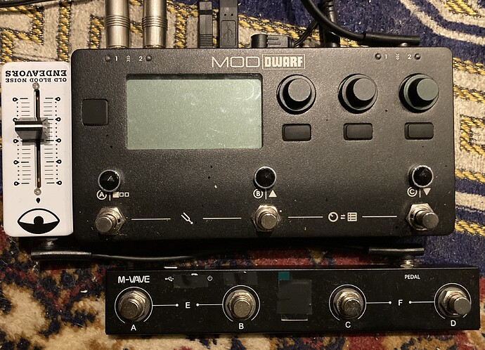

The cheapest and smallest solution I’ve found is to get the Chocolate controller for about £25 from Ali express and plug a normal expression pedal into it.
This works for me and you get 4 extra footswitches thrown in, powered by the mod through USB, with a tiny form factor.
I’ve built my own auduino controller with 2 expression inputs (and 4 buttons and 2 knobs!) but the chocolate units much more pocket able and robust.

no worries - dont forget exp pedal is backwards so you will need to adjust at the Dwarf
Here’s a link to the forum post - credit to @SrMouraSilva for investing so much time in it.
Note my little fix for inverting the Expression Pedal operation if it’s wired the wrong way around.

The editor has been updated and now allows for inverse CC so can put the expression pedal the wrong way round to make it the right way round ; )

Here’s a cool way to use the expression input on the M-Vave chocolate:

Did try to get the inversion to work but no joy at present. Will give it another go over next xuple of days to see if I can work out why
