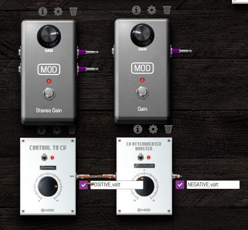

So let’s assume I want to control 2 knobs, how should I do the value mapping?
Say I want one knob to go up and another to go down when I press the pedal down?
I can only respond in theoretical terms, because I won’t be able to use my MOD at least until September, if not more.

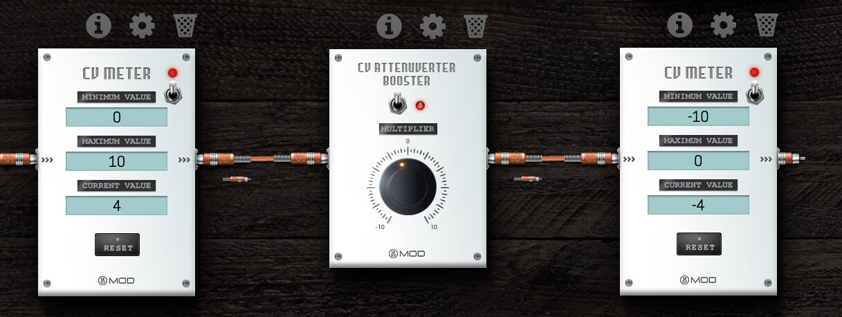

What you need is the Attenuverter Booster plugin. If you set it up as per the picture below
The output of that plugin will give you the exact inverted voltage of the value you are inputting.
Therefore, you can map positive voltage to one plugin control and the negative to another one. In the picture below, moving the Control to CV (bottom left) clockwise increases the value of the pedal above it and decreases the value of the other one, which is mapped to the Attenuverter:
(Remember that the positive one must be mapped as Unipolar Positive – 0 to 10V – and on the inverted one to Unipolar Negative, -10 to 0V).
Sorry, this is as much as I can offer for the time being. Good luck.
