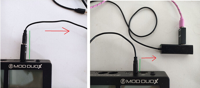

Would it be possible to use two chocolate in parallel to have 8 switches available?
If it’s possible to connect two or more midi devices into a mod equipment, I think that it’s possible to use more than one Chocolate.
But probably won’t be possible use a same Bluetooth adapter for both chocolate controllers. Then, you will need to use a USB hub to connect both with mod dwarf.
But if you connect one with the Bluetooth dongle and other via usb maybe works. Note that the USB dongle has a USB input, so it’s possible to connect the USB dongle into dwarf and the USB cable into USB dongle. But I don’t know if a conflict or something like this will occurs.
Sounds to me like a lever to increase chances to break usb port heavily, when you pull usb cable accidentally. (And that’s inevitable at some point, imho). We have only one port on the quite expensive device to risk like that.
One thing is to just connect the dongle, but when you also have a cable on the floor between chocolate and dongle waiting for you to hit it by a foot when moving around and being focused on the guitar, it is somewhat another story without a happy end quite probably. I would suggest using USB hub instead to reduce levering almost three times. Using some velcro to mount usb hub to the side of MOD should be even better, if you can find a hub that fits.
