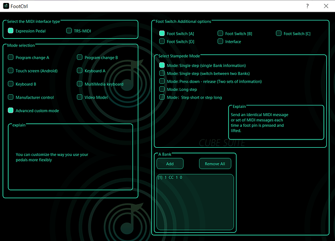

I received the M-Vave Chocolate today, but I’m facing some problems trying to control the Dwarf. Perhaps someone can help. Clickling a footswitch (e.g. FS ā€œAā€ ) on the Chocolate, I only can manage to turn OFF plugins. It’s not possible to turn them ON once again. Only when I click with the mouse in the gui..I also tried the workaround with the CV, but I have the same problem, the it only ā€œgoes in one directionā€ā€¦ On which midi messages do the plugins react?!
Here are the settings in the CubeSuite Software (windows). I also cannot find the control mode (like it is described in the tutorial SrMouraSilver).
So I’m a bit confused. I have to say that I’m quite new the whole midi cc, pc, etc. stuff.. so surely its my fault.. but nevertheless it would be nice if someone could help!

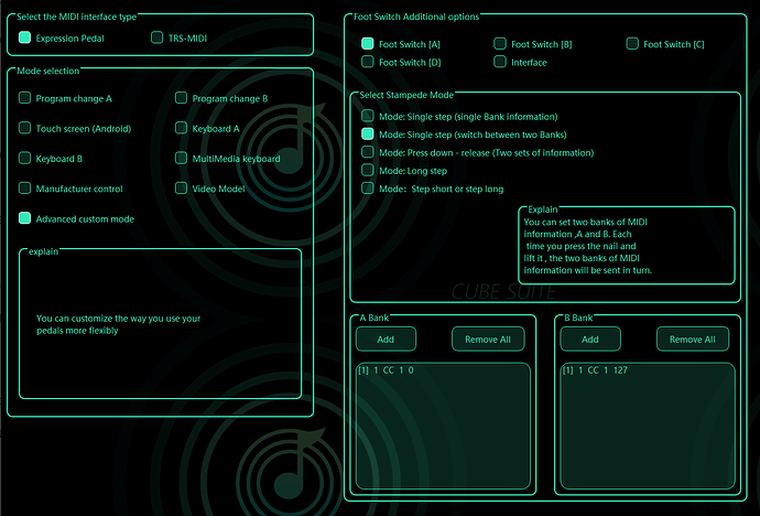

Select
Advanced Control Mode
Single Button switch between 2 banks
to control fx on and off set the chocolate to custom profile at the bottom of the list.
Then choose A then B button behaviour.
Choose CC For Button A
Midi Channel
CC number
Then 0 for second value.
Do same again with B value but this time the 2nd value is 127
Check what your chocolate is sending out using any midi monitor - I use MIDOX but there are plenty of others.
The behaviour you want to see is the value 127 on first press (On) and then 0 on second press (Off)
A BANK
CC 1 21 0
B BANK
CC 1 21 127
Not used the windows editor - i use the android app which looks slightly different. Will download the pc version to confirm the steps.
Hope that helps - if you are still struggling let me know and I will post pics

Yes, I’ve managed it to get it work! thanks a lot for your help!
Here are the settings:
The only thing I find a bit annoying for live use is the lack of visual control of the chocolate to see if a plugin is on or off. The display only shows only two zeros (00).
