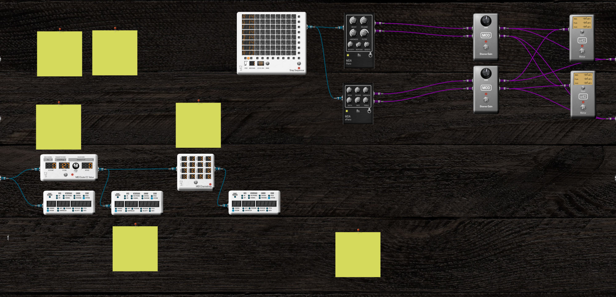

Jumping on this old topic as I have the same problems with my Akai LPD8.
I solved this by using the “MIDI Scale CC Value” plugin. All pads in toggle mode on my LDP8 are programmed to use cc values below 32, all knobs use cc values above 31. “MIDI Scale CC Value” is configured to change only data for cc values between 0 and 31. So pads are changed, knobs are untouched.
But that is not enough because the midi learn algorithm catches the original midi event.
So I added the “Midi Channelmap” plugin to shift the midi channel up (from 4 to 5 in my case) and forwarded the signal to the “Virtual MIDI Loopback” (enabled in the midi port settings) to make the event available as midi input.
But still the midi learn algorithm catches original midi event.
To overcome this limitation, I copied the “program” 1 on the LPD8 which sends on midi channel 4 to “program” 2 and changed the midi channel to 5. The “programs” on LPD8 can also be considered as banks in my opinion.
Now I can use “midi learn” for the LPD8 pads with program/bank 2 and use them with program/bank 1.
This scarifies one program/bank on the LDP8 just to learn the pad events.
I have annotated and published my test board to show the setup:
It would by nice to have some logic in the in the advanced section of midi learn for a toggle to map the midi values (e.g like the “MIDI Scale CC Value” plugin does). It seems that not all vendors use that standard.
