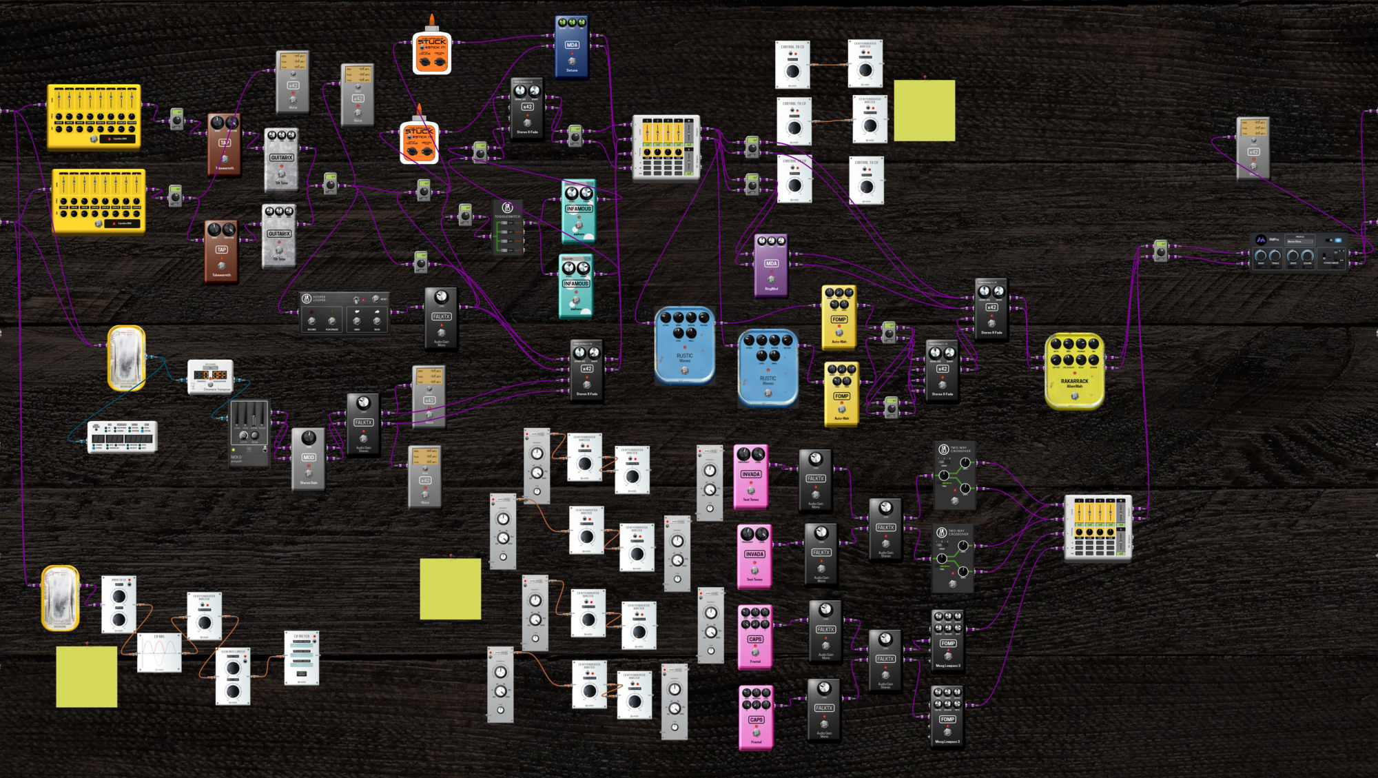

Care to share the pedalboard so that others might try to reproduce?
hey @dreamer i wish i could… the share dialog gets stuck on “waiting for a screenshot…”.
…oh, oops: it just takes a very long time to make the screenshot! :stuck_out_tongue:
finally got it, and here it is:
…note that i’m on a Duo X LE
@plutek I saw that there are some Beta-Plugins in the board. Maybe this is the reason…?
i suppose that’s possible… i’ll try swapping those out after my show tomorrow.
although many of the beta plugins are irreplaceable. :frowning:
