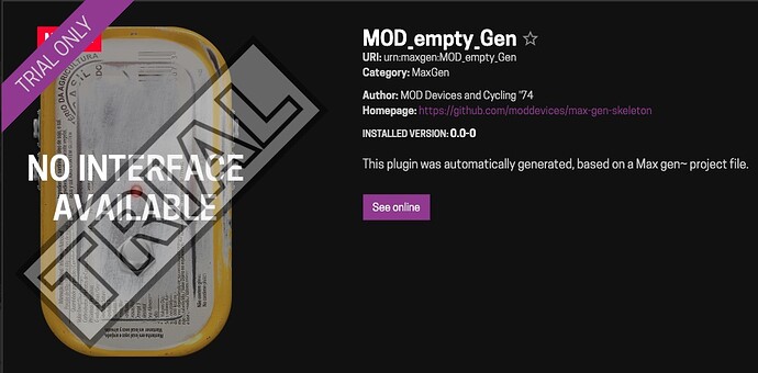

So I tried with the empty example of the MOD-DUO Launch, but the problem remains the same: only TRIAL :

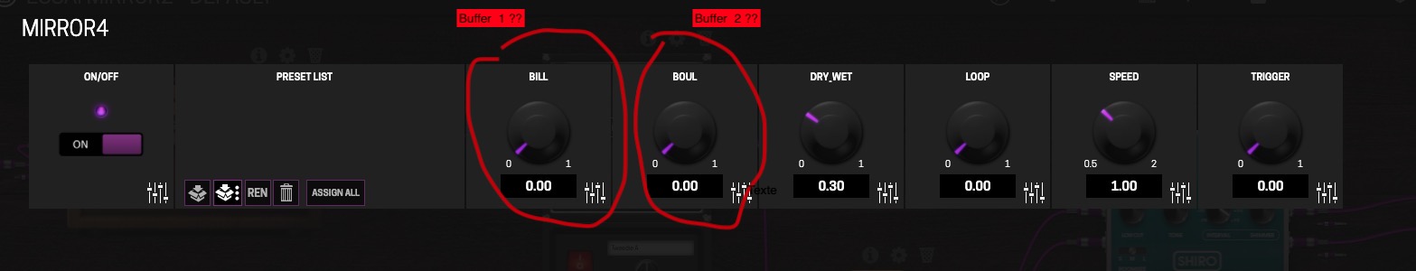

Another strange thing is the appearance of two knobs in the name of the two buffers used in my plugin while no parameters are assigned to these buffers in my GEN patch…??

The extra parameters are a side effect from how max gen works, you can just ignore those parameters.
If they really bother you, edit the main plugin ttl file and set those as OutputPort instead of InputPort.

And finally, regarding the “trial” plugin, somehow the plugin is being identified to be built as commercial. I don’t know why yet, will investigate.

I think I found the problem and a fix for it, triggered an update to the cloud builder just now, but will take a few hours before it comes online again. So around noon tomorrow (2022-04-20) hopefully the demo/trial mode situation is fixed.
I also updated the Max gen~ - MOD Wiki page so the tar for manual procedure is now at v6.
Changes are to support both python2 and python3 (tested with the latest python3.10) and also support for multi-device builds. The same ./mod-build.sh script will give you duo, duox and dwarf builds all at once. The ./mod-deploy.sh then needs an argument to specify which build to deploy, but will try to find it automatically if possible (requires jq command-line tool to be available).
Will let you know tomorrow if the cloud side build went ok.
Demo/Trial mode should be fixed now, sorry for the inconvenience.
Try it out when you can and let us know if it works correctly now.
Thanks!
YES, wonderful, I just tried, the demo issue is fixed. It worked perfect with the Mod Duo Launch.
I did try also the manual procedure and it’s ok too, it gave me back the lv2-dwarf.tar.gz file.
