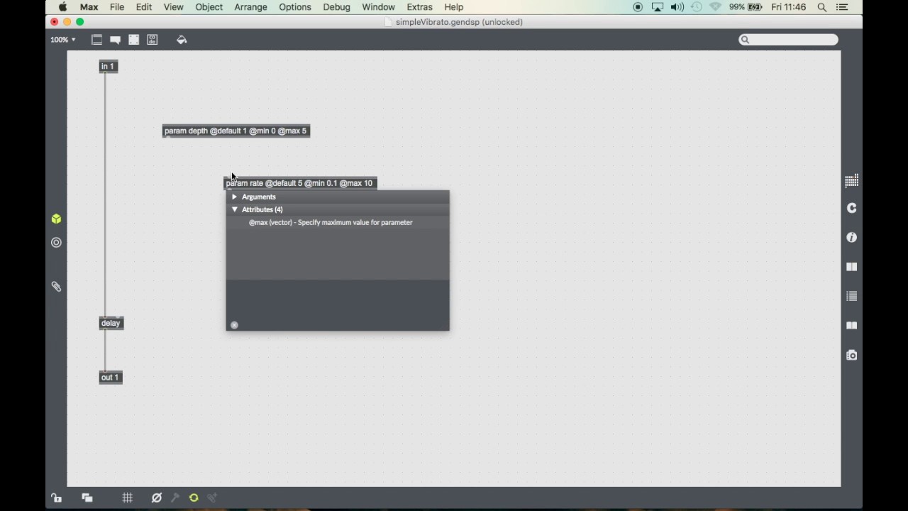

You’re running the max gen build manually. So it’s only meant for developers which are looking to use the tools and have control over the process. For typical users it’s much easier than that. Here’s a video showing the integration between Max Gen and a Duo (it will work seamlessly with any device).
I can confirm it works using the MODwatcher in Max itself. So thanks for that!
