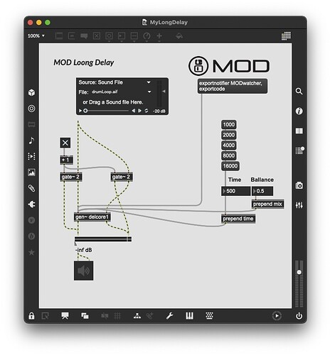

I just tried to compile a fairly simple GEN patch (just a very long stereo-delay), following the WIKI pages, and got the following errors:

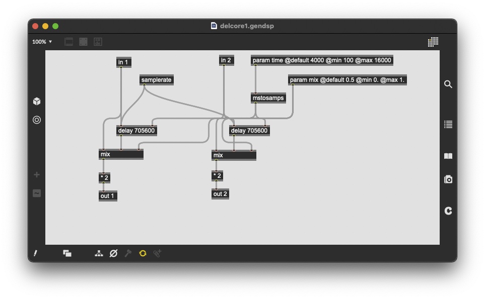

Here is the patch and the inside of the gen object:
