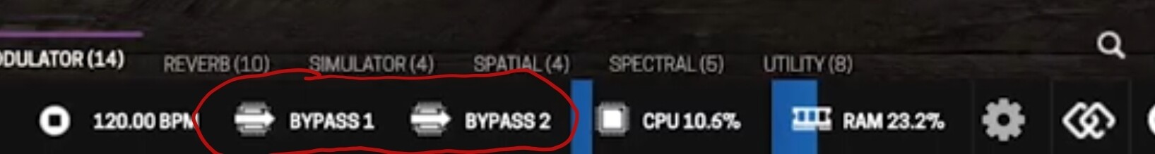

Are you sure that the bypass relays are not engaged?
You mean these right?
Those are not engaged, but engaging them let’s me pass the audio through to OUT 1 and 2 at least. So the outputs at least works, but not through any effects.

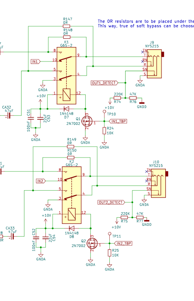

Looking at the schematic for the MDX bottom board I see that the hardware bypass relays have a ground connection.

From top of my head it would be:
  1. Find this relay datasheet, and determine which pins are responsible for what and map that to MDX schemattics.
  2. Knowing pinout - find how controlling signal behaves, is relay even getting proper command to open/close? Is it stuck permanently in one state?
  3. If relay gets enough voltage to work
  4. Look if all condensers are fine - I am not a seasoned electronics expert, but for what I know these guys are usually the first to die of age or just because they like toi.
For example - you see that controlling signal is fine, in that case it is relays or their power supply (or maybe some condenser is dead and does not handle consumption peak during switching) .
Or for example you see that control signal does not change, in that case changing relays would not help,.
In the almost-worst case, if there would be no other options - you might be able to get rid of the relays at all and hardwire connections in a permanently “on”, no-bypass state, loosing the hardware bypass ability. (I actually never used it, so it would be feasible for me for example). Bypass the bypass, in other words.
