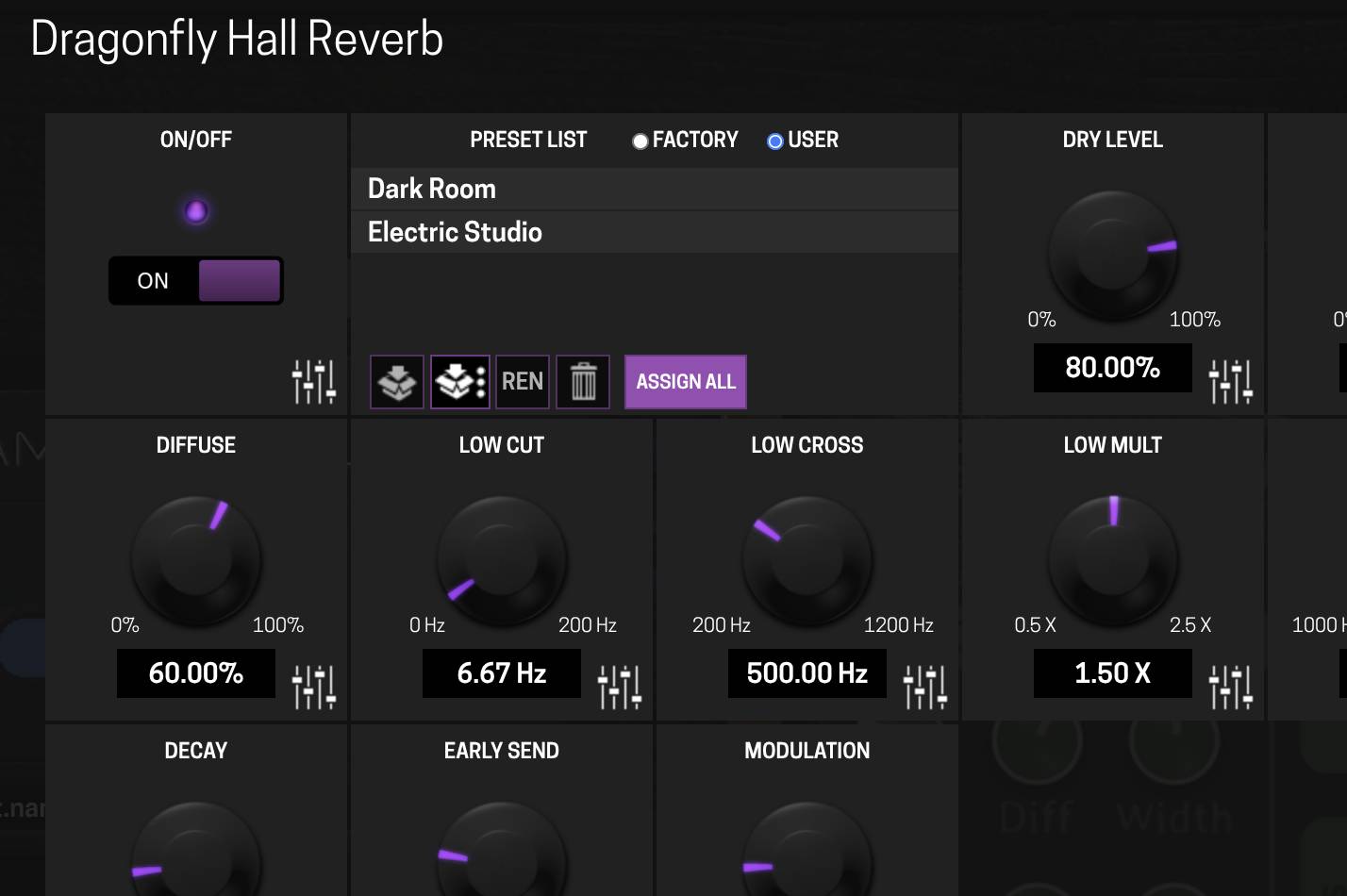

I put my user presets on a button on my MOD Duo X, but instead it also spilled the whole stack of work presets on the click-through button as well. I wanted basically 3 hall presets, now I have that an 20 work presets I never wanted :thinking:
Hey @tiktak,
I’m not sure if I fully understand your issue. But likely you saved something as a plugin preset and to access it, you need to go through all the plugin factory presets + your presets. Am I right?
Would using device snapshots not solve your issue?
Hi João, thanks for gettongnin touch!

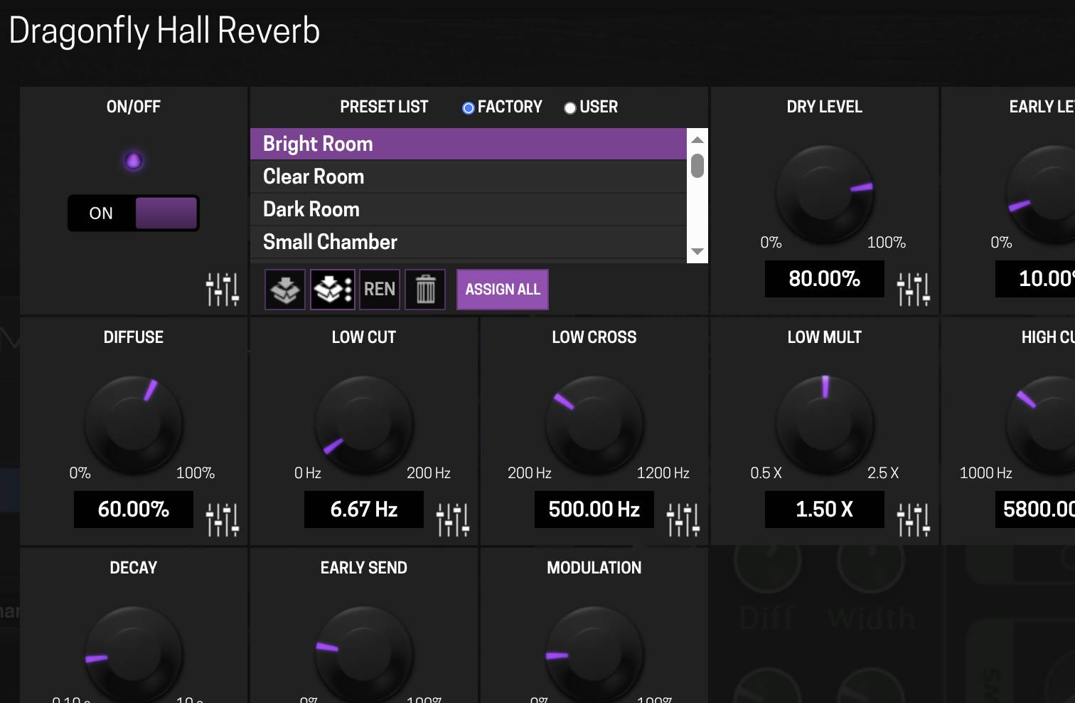

Sure, here photos… Seems, like the assigning my user presets get scrambled together with the factory presents.
(I’ve tried to upload my screenshots. But the form system denied me that- maybe because I’m new)
Sorry, I wrote 'here are some photos '…here they are:
So, after assigning my user presets to a button on the physical unit, I do now have Factory AND user presets.
Think, this appears only on that dragonfly reverb
I upped your permissions. You should be able to edit now.
Hey @tiktak,
this is actually a downside of using assignments for plugin presets.
My suggestion would be to use pedalboard snapshots. Each stored with the right preset.
