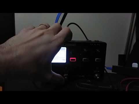

LV2_HMI_LED_Colour led_colours[] = {
    LV2_HMI_LED_Colour_Red, LV2_HMI_LED_Colour_Yellow, LV2_HMI_LED_Colour_Cyan, LV2_HMI_LED_Colour_Magenta,
    LV2_HMI_LED_Colour_Magenta, LV2_HMI_LED_Colour_Yellow, LV2_HMI_LED_Colour_White
LV2_HMI_LED_Colour current_led_colour = led_colours[<PARAMETER VALUE>];
self->hmi->set_led_with_brightness(self->hmi->handle, self->hmi_combobox_addressing, current_led_colour, LV2_HMI_LED_Brightness_Normal);
A led colour was on only on B. Ok. This coudn’t be considered a problem. but press C and see the result. The led on B is turned off. Press C and it go back turned on.

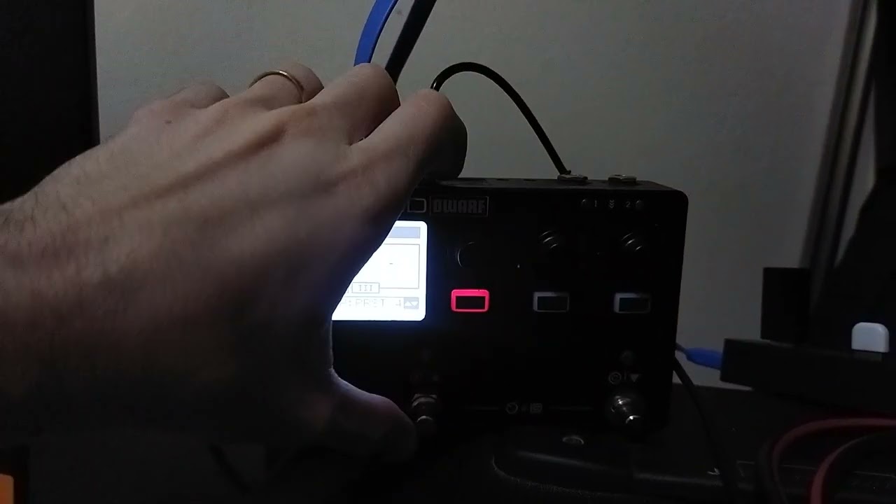

CASE 2
Create a plugin with the following parameter defined on .ttl as described above.
Assign it to B or C (but not both).
Change the label value.
char short_message[10];
sprintf(short_message, "%d", <PARAMETER VALUE>);
self->hmi->set_label(self->hmi->handle, self->hmi_combobox_addressing, short_message);
Noticed that the presented value is a strange concatenation between the defined value and the lv2:scalePoint. There isn’t possible to replace totally the label value with the defined on set_label.
Another strange behavior: if hmi->set_label is never called for a parameter, the label will always shows
the lv2:name (as expected). But if hmi->set_label is called when the parameter is changed AND you changes the parameter value using mod ui parameter settings page
sometimes instead of showing the text defined using hmi->set_label, will shows the lv2:name. When it occurs, if you define a led value, it will be turned off too.
More one strange behavior: if you change the hmi->set_label by a MIDI message assigned for another parameter (that causes update on enumeration with control input port request change extension), the strange concatenation will be partially updated: the first part (that contains what as defined on hmi->set_label) is updated, but the second part (that contains the lv2:scalePoint current value) isn’t updated.
