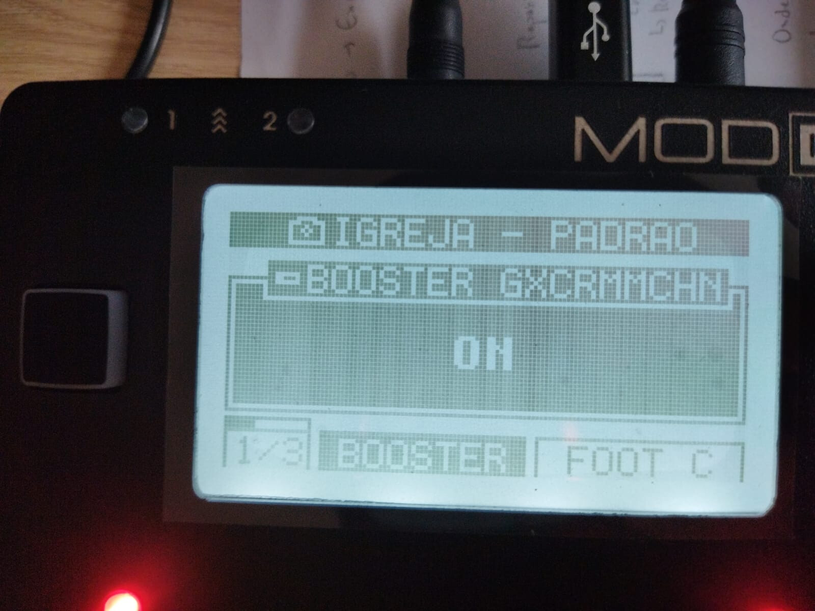

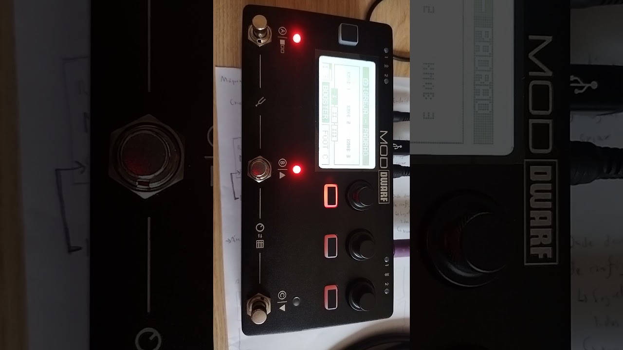

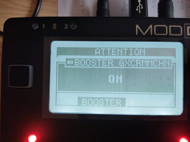

- Press the center and right footswitch concomitantly, the equipment will show the following message:
ATTENTION: Please disconnect the web-ui... - When the message is present, try to press a footswitch or rotate the rotary encoder
- The display will show a mixed message. (This is expected?)
A sample:
Expected/suggested solution
Actually, I don’t know. Maybe appears the original header (Pedalboard/Patch name) instead ATTENTION.
