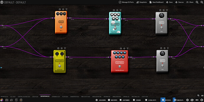

If I understand you correctly, you want to have your chapman stick (which has 2 outputs, if I’m not mistaken) connected to your duo such that chapman_out_1 → duo_in_1 and chapman_out_2 → duo_in_2.
Then, inside the Duo, you want to send duo_in_1 to both duo_out_1 and duo_out_2 through each of fx_chain_1 and fx_chain_2. And also send duo_in_2 to both duo_out_1 and duo_out_2 through each of fx_chain_1 and fx_chain_2.
If that’s correct, you can achieve this by using multiple connections like in the attached image:
you’ll probably want to add some 2:1 mixers to get the right blend of both channels, but this is the basic idea (assuming I understand what you’re trying to achieve)
I was just thinking through this again and you probably don’t need the double connections on both ends, just one or the other. Unless you want to do some interesting mixing.

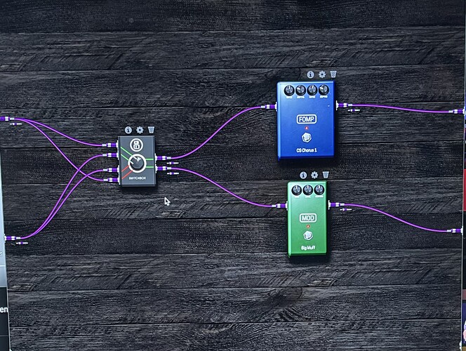

Okay—I don’t mean to keep dominating this thread, so my apologies for that—I checked my Dwarf and the 2-in 4-out does exist (Switchbox 2-1 ST) and is installed on my device, but it won’t actually work for the purpose—because it diverts rather than swapping, which I should have of course realized in my head.
So, I stand by my first post as the best solution.
HOWEVER—if you don’t necessarily need the swap to be instantaneous, you could mess around with Stereo X-Fade to see if that works as a single plug-in solution. I haven’t experimented with it so I don’t know how short you can set the fade to, but on the other hand a long slow swap between pickups while you’re playing could be a really interesting take on a filter effect depending on how you EQ.
EDIT: I’m an idiot. The one that won’t work is Switchbox 1-2 ST, which is 2-in 4-out, so that was correct. But I didn’t mention that one above. On the other hand, Switchbox 2-1 ST which I did mention and is 4-in 2-out will work:

Genius!!! love you!!! thanksss
i can’t found this pedal on my library causa a can’t log to Mod Cloud, can you share me the pedal???
