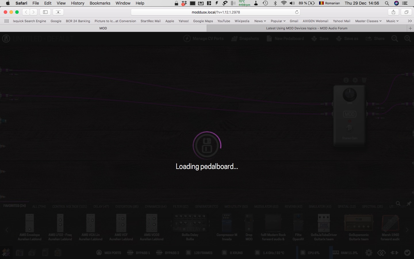

There is something happening since the last update I made to OS version 1.12.1.2978 on my Mod Duo X. Everytime I open the interface I get this “loading pedalboard” message for a very long time. It finally starts only after refreshing many times the interface page in the browser. I think it has nothing to do with the internet connection, I checked it and it’s OK. Does anyone have any idea ? Thanx, guys.
It is quite probable that you were as greedy as me, and had installed all the possible plugins from beta and non beta store.
At least that’s how I’d ended up with having the same slow loading as you
Removing unused beta plugins should speed up things in theory.
Most probably it spends all that time listing installed plugins, loading thumbnails and metadata for them.

You have 794 plugin installed…this will take a very long time to load…maybe look at shaving off at least 150-200 plugins to get down to acceptable load times…anything over 500 takes a bit to load and it’s not fun.

@qtguy20000 this can depend on a lot of things but never really on the Internet connection speed since you are doing a local connection into your MOD. That uses a browser but it’s not dependent on the internet and the only things that make any sort of usage of the internet in the WebGUI are the cloud connection and (also related to the cloud) the plugin store. But even in a place without internet, you will be able to access the WebGUI (just not the plugin store for example).
@qtguy20000 and @AndyCap the speed that the pedalboard loads and shows up depend on a few things. As @ignis32 and @micahvdm pointed out the number of plugins installed is one of them, so it is the number of pedalboards stored on the device, the number of files in the file manager, etc.
Another thing that influences quite a lot and I’m sensing that it is your case @AndyCap is how heavy are the plugins in the pedalboard that is loaded. If the plugin requires more CPU and RAM it will take more to load the pedalboard and vice-versa.

Besides everything that I wrote before the particular showcase on the WebGUI also depends on the browser and cache. For example, if the images of the GUI of all plugins are stored in the cache of your browser, the loading time is expected to be faster and vice-versa.
Takes about 15 seconds to open pedalboard interface with 595 plugins installed.
Still much better than when I had with ALL 830+ plugins before removing tons of beta tuna can plugins, which I do not know what are for anyway, due to the lack of descriptions. I do not know exactly how long it it was with 830+, but feels much better now, even if still not perfect.
