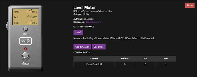

On the meters you have a Level Meter plugin in beta
But yes, as @LievenDV described, you would need to basically put one after each single effect what may get a bit messy.
