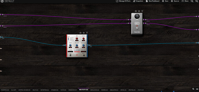

Hmmm, I use the arpeggiator a lot and never seen this delay, can you share your pedalboard or at least post a screenshot of it?
A screenshot will not add much at all. It just shows the Arpegiator connected to midi in and out on the UI and that’s it. I’ve done further quite exensive testing with Mod Duo around host tempo sync and it just does not work. It kind of follows the host tempo but with very low precision and goes out of sync rapidly; Certainly when changing tempo. For me right now the device is useless. If no satisfactory answer from support, I’ll have to return it.

The screenshot you show doesn’t have the arpegiator synced to the host clock, btw.
