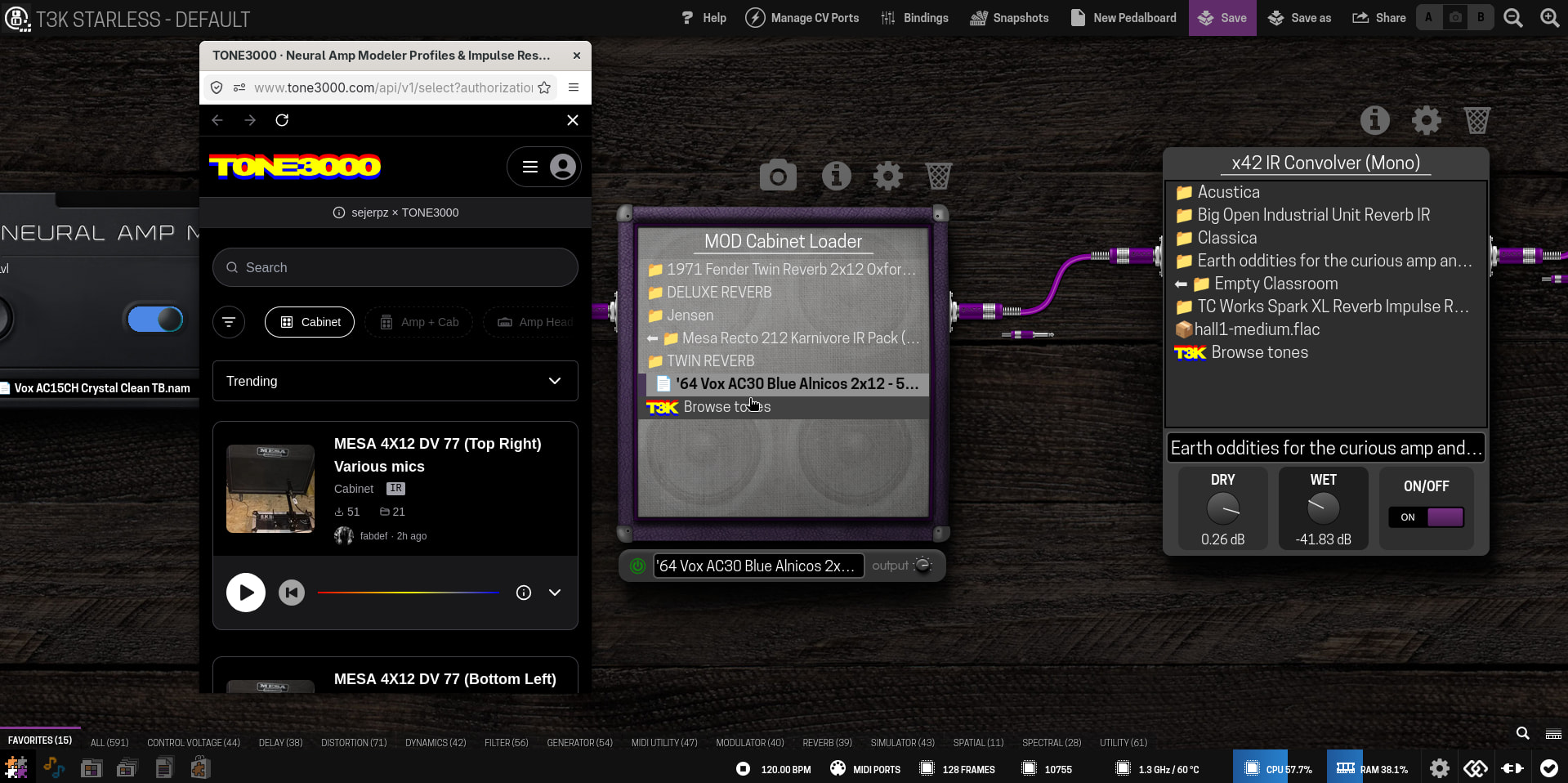

However, the MOD Dwarf is fairly limited in terms of CPU power, so these days I mostly use MOD Desktop, or run mod-host and mod-ui directly instead.
I’d really like to use the Tone3000-implemented NAM in this environment.
Since NAM is an LV2 plugin, would it be possible to port the Tone3000-implemeted NAM to an x86_64 environment?
Or would this require changes to mod-host or mod-ui as well?

What I mean is that I want to use the nam.lv2 included in the Starless version on MOD Desktop as well, or with mod-host and mod-ui.
I’m referring to the downloader shown in the video.

I’m currently using a Jackd + mod-host + mod-ui setup on Debian Linux.
With the recent commit to mod-ui, plugins such as nam.lv2 and aida-x.lv2 can now access Tone3000. To enable this, you need to manually obtain a Tone3000 API key and add it to html/index.html, html/t3ksplash.html, and html/js/lib/t3k/config.js.
The hierarchy listing feature has also been implemented.
