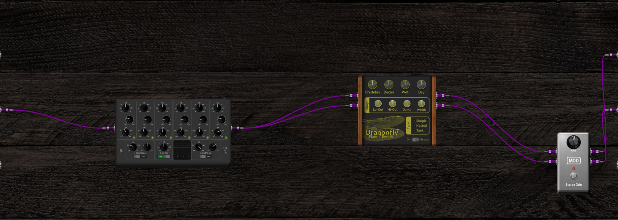

Until now I did not succeed in satisfactory results with IR for classical guitar. The best solution for me was to use a Match EQ to compare the simultaneous recordings of the acoustic sound and the internal mics (K&K Pure Classic + mini crown mic → 2 channels preamp). And then to imitate the EQ curve with the x42-EQ-Parametric. If you want to try, here is a simple pedalboard with the x42-Parametric assigned to the Dwarf knobs and switches :
