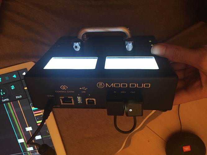

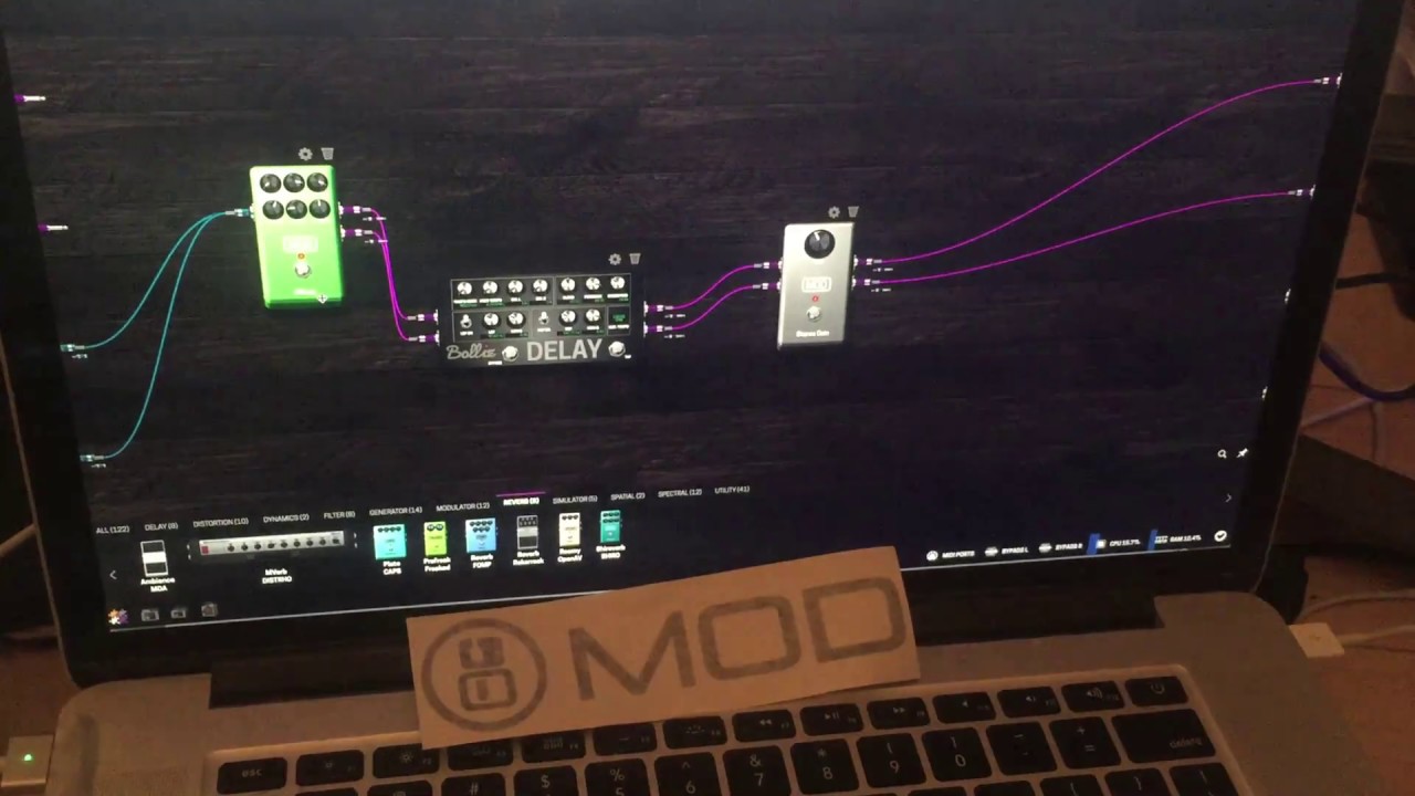

Hi MOD Duo Users,
i would like to know which way is the Best to make a connection MOD Duo and iPad ?
i just try to BlurTooth MIDI from iPad to Quicco mi.1rev3 (its BlueTooth MIDI Sender/Receiver which made by Engineers who quit YAMAHA) .
it works well , i guess. this is test movie (sorry, the video quality is bad..)
I got MOD Duo 2days ago, and just try to Wireless MIDI.
But i didn’t know there is a BlueTooth Donge/USB Connection Way.
then, i just tried to use Qicco m1.rev3 (sometimes i use it with Axolotl)
i haven’t test BlueTooth Dongle, so I’m not sure which way is better (of course its depend on the situation)
if somebody knows , let me know more better way !
(because I’m beginner)
i wanna know 2 good ways about good connection ways of iPad Apps to MOD Duo with “USB-WiredCable” and “Wireless way”(because its depends on the situation, and i still trust Wired Connection)
Of course i’m checking MOD Forum, but i couldn’t find the best answer.
Is “iPad with Bluetooth dongle ver4” a best way ?

I use the MD-BT01 as MIDI Interface for Pad to a MIDI-Device. (in my case a Kemper -Profiler) . The MIDI out has to provide the power-supply. As far I’ve seen at the above Video it is realized in the MOD Device (LED is on).
Therefore, I do not expect any problems with the Dwarf, which I am already eagerly awaiting.
