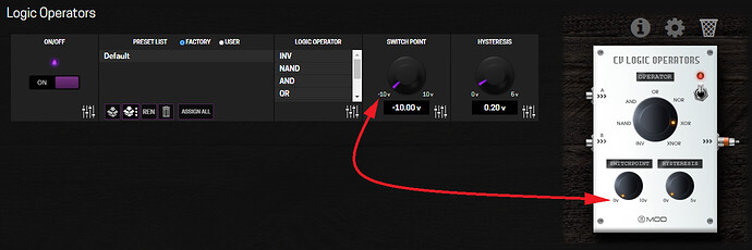

In the MOD CV Logic Operators plugin, the lower bound for the Switch point parameter is -10V, but is marked as 0V in the GUI.

  1. Load the plugin and compare the numbers :slightly_smiling_face:

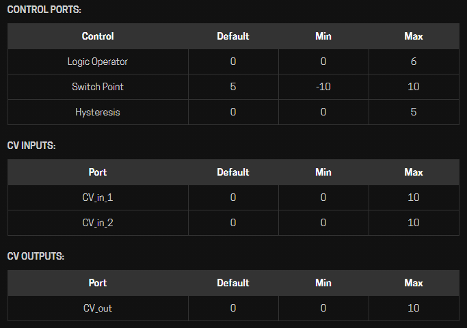

The plugin description lists the minimum for both inputs as being zero, so allowing the switchpoint to be set lower than zero seems redundant. I would expect the switchpoint minimum to be changed to 0.
Alternatively, if the switchpoint should go down to -10, the minimums for the CV input should also be -10 and the plugin GUI should be updated.
