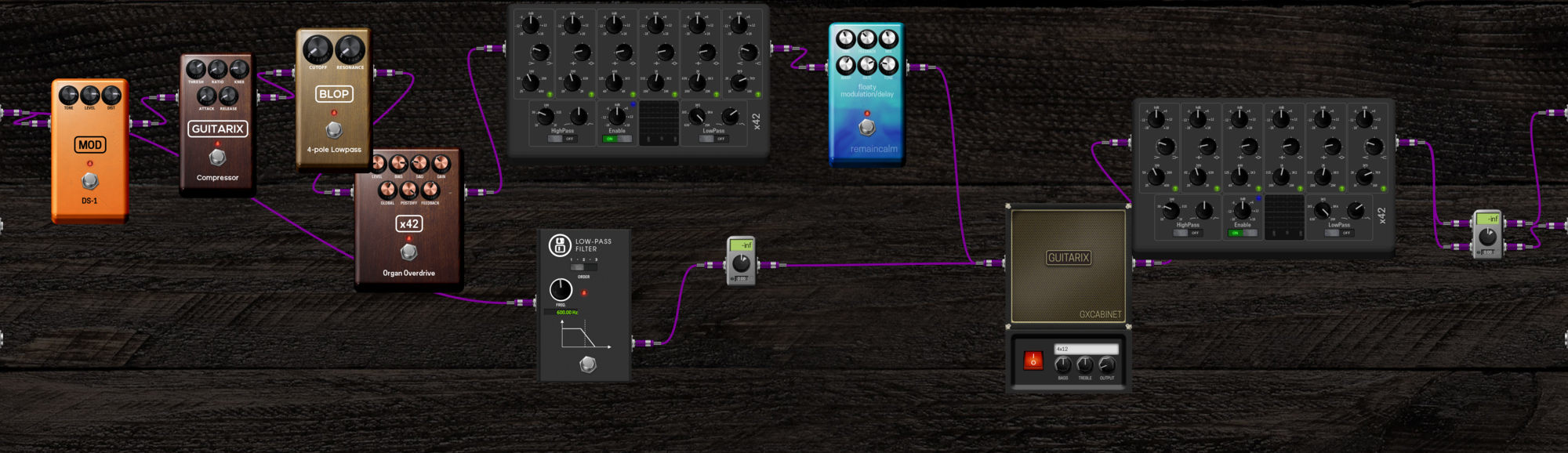

Here is my attempt to a Darkglass style bass distortion sound.
I just added a DS1 plugin on the top side of my effects chain and blend in the LPF bass.
I kept the floaty on there because I think it adds a little something…
I have a mute assigned to Footswitch1 and the DS1 on/off programmed to Footswitch2.
