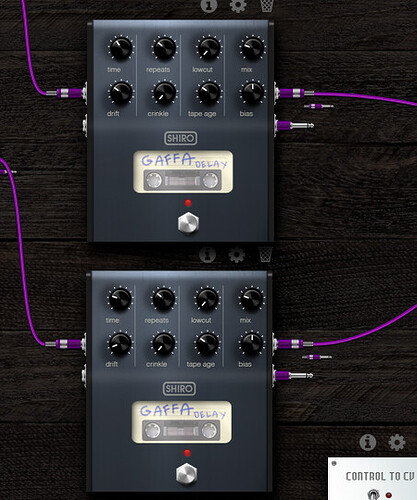

I’m looking for a way to control 2 @SHIRO-Plugins Gaffa Delay with a tap tempo, one delay on tempo the 2nd “a bit” longer. The way I do it until now is
  • set the 1st delay time sync with the main MOD tempo with Translate value to musical tempo checked and set to 1/4
  • set the 2nd delay time sync with the main MOD tempo with Translate value to musical tempo checked and set to 1/4·
The result is good but :
  1. I’m stuck with the 1/4 and 1/4· values, it is not possible to make those available to change with a pot (I have to get a computer (or fight with Bluetooth and my smartphone) to make the change with a browser)
  2. I can’t get something more analog like the 1st delay (still) 1/4 and the second just some ms behind, to have the 2 signals “never” align
Has anyone a clue to solve this puzzle ?

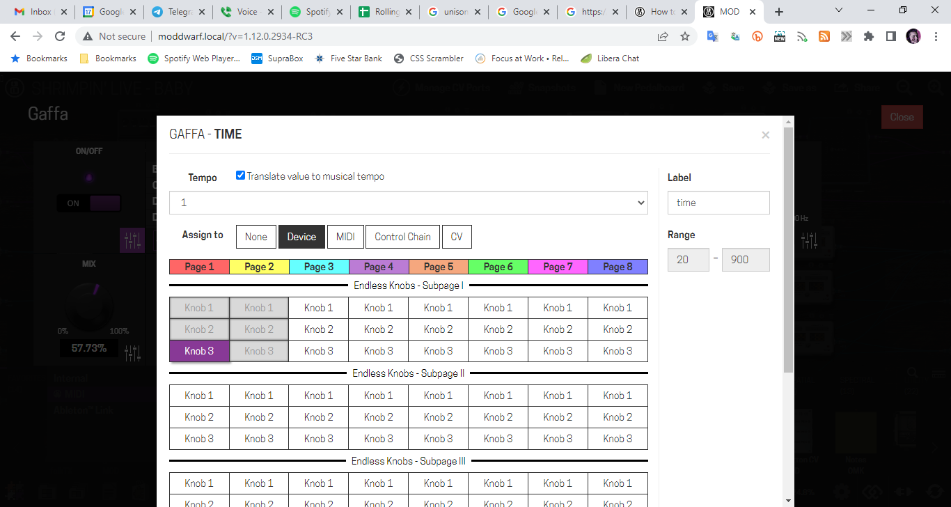

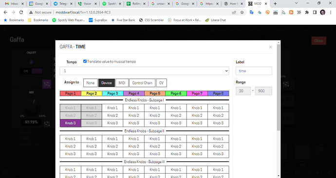

You CAN make these changeable with a knob! If you select “translate value to musical tempo” in the pedalboard designer and then assign the time value to a knob, you get a list of the musical tempo values when turning the knob on your device! Doesn’t solve your second issue but just wanted to make sure you knew about this feature!
Thanks for the advise, but as I said in my 1st post I’ve checked this box (to get the tap tempo on a footswitch). The thing that I can’t change with a knob is the way it syncs (1/8 or 1/4…) with the MOD clock. Or can I ?

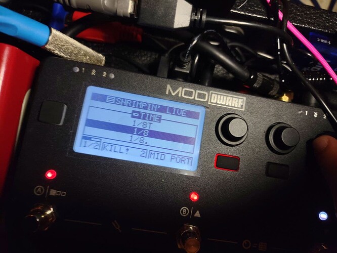

Yes, that’s exactly what I’m saying! Here, I’ve got the Gaffa time assigned to knob 3 in musical increments!
Just had to set it up in the GUI like this:
Wowowowowowo !!! Thanks !!!
