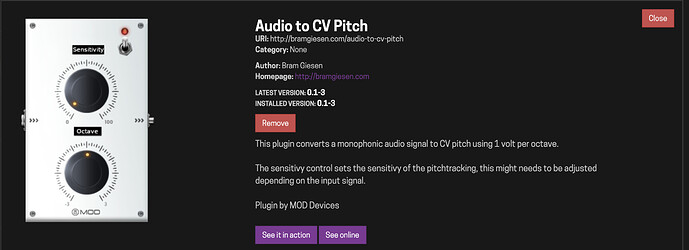

There’s not yet a Audio to MIDI available in the platform.
What you do have in beta is a Audio to CV Pitch plugin. This allows you to convert Audio into CV pitch.
