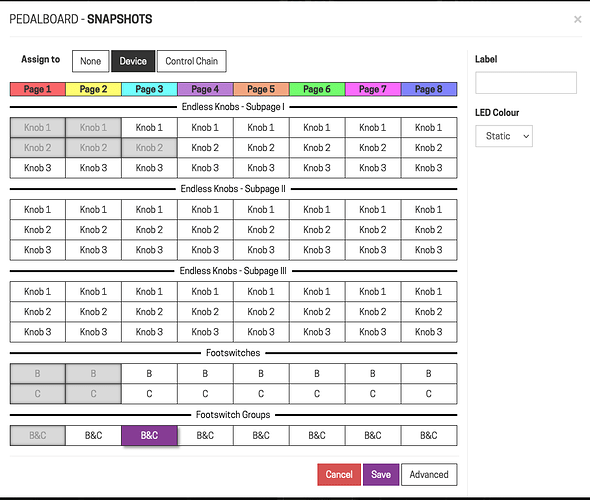

Is there a solution to erase the knob and footswitch configurations recorded on a pedalboard?
(screenshot)
Thank you in advance for that.

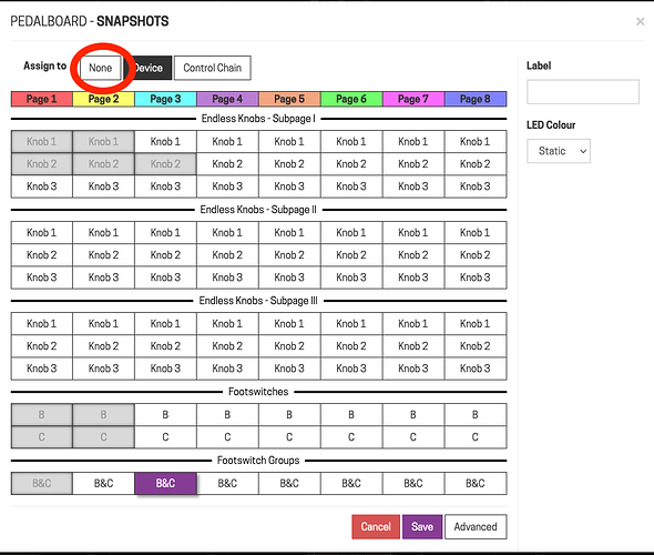

As far as I know there’s not a really fast way to do this (and we are aware that eventually we should have it).
Basically you need to go to each assignment, select the “None” tab and hit save. This will remove that particular assignment.
Jon, thanks for your response.
I cannot select the assignments tabs, they are grayed out and I do not have the hand to do the procedure you have instructed me.
So I would wait for an update that will make it easier.
Besides deleting a selection or all knobs, moving a selection of knobs would also be very helpful.
It’s not on the assignment. It’s up where you have “None” / “Device” / “Control Chain”.
Click on “None” and then hit “Save”

Jon, I am sorry but I cannot perform the procedure indicated on the knobs and footswitches which are grayed out.
Forgive my stubbornness in this problem.
Ok it works!
Thx !
