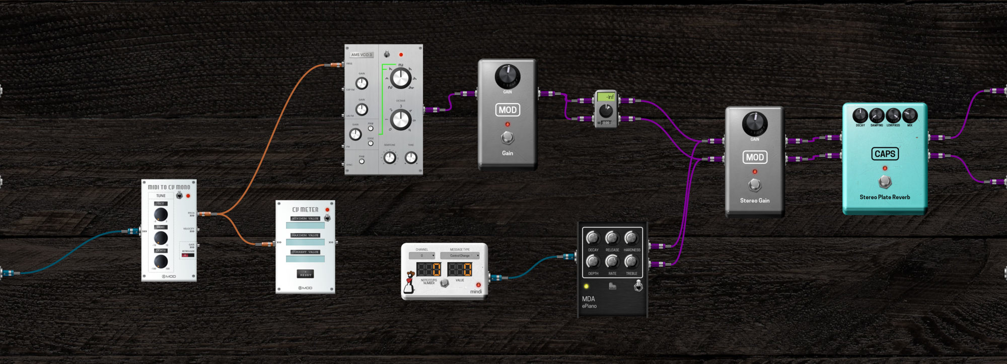

About your other question, there is not such a plugin that does CV to MIDI note messages are this time. Something like that can perhaps be done by adressing a CV output to the MINDI plugin though… check this out:
Hope that helps!
