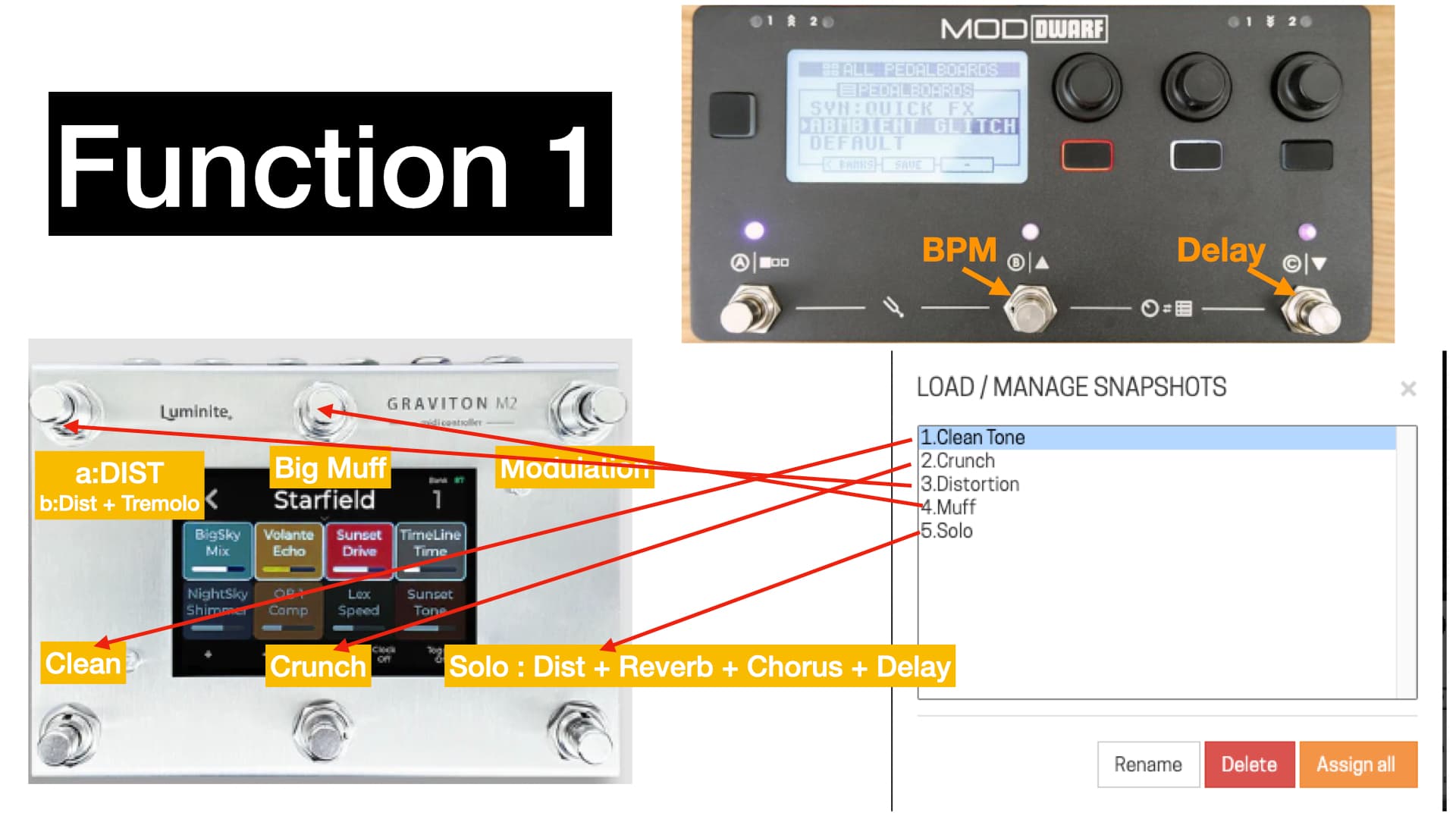

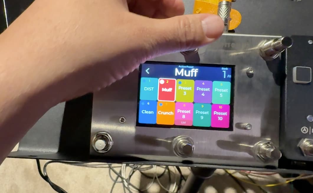

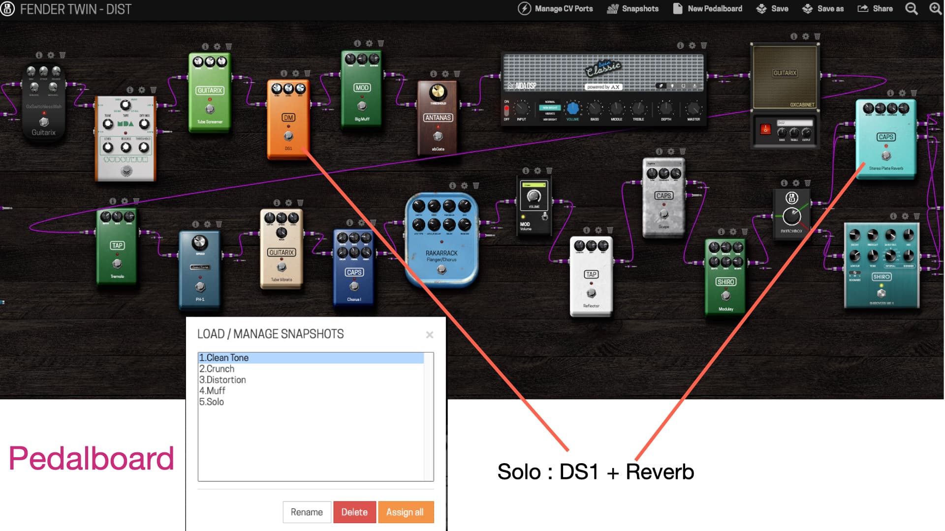

The [Pedalboard] picture is my preset pedalboard.
I created 5 snapshots.
Can I set five foot toggle to control these five sanpshots?
I hope I can setup my 2 Function
Please help me

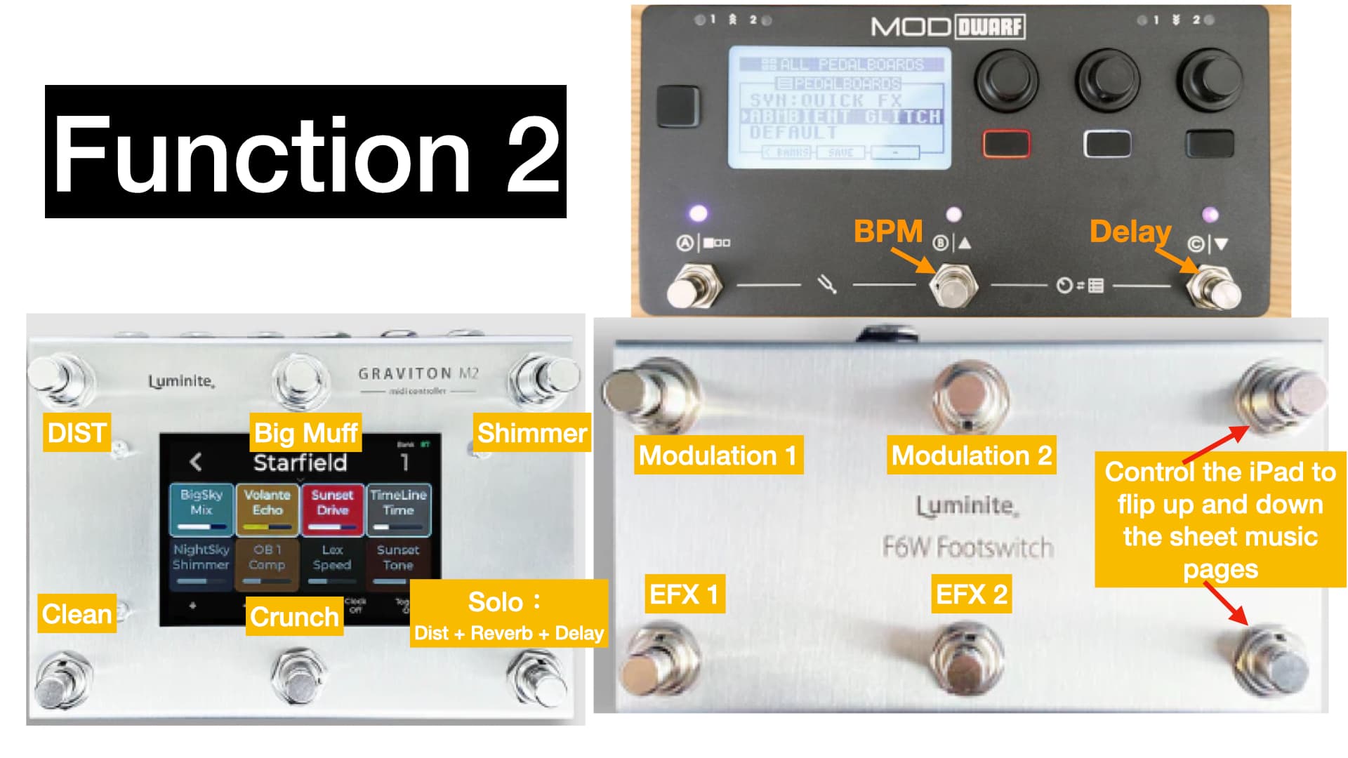

Please help me

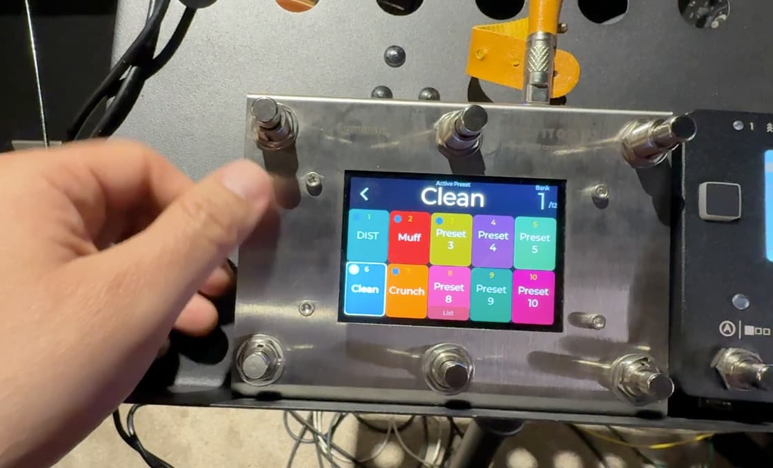

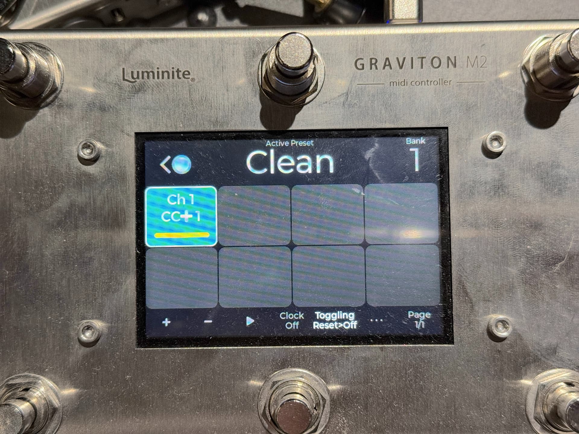

Hi
Can you send multiple messages per switch with your midi controller ?
If it is the case you can assign each effect witch a midi message, then use a footswitch to change the states of multiple plugins at once…
I don’t know your midi controller, sorry… I think you’ll have to read the manual.
On the Dwarf side you just have to assign a plugin’s button (on/off, or any potentiometer…) to midi. Then the Dwarf will wait to the midi message.
You will repeat this for each plugin you want to control.
Hi @Ho_James,
Here are the wiki paragraphs related to your request :
You might have to read more than just the paragraph to understand. Let us know if you still have problems.

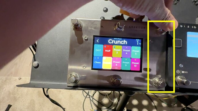

Thank you so much, it’s working now! But I’ve encountered another problem: for some reason, the two right side toggle switches on my M2 aren’t responding.
Thank you guys ! I reset my foot controller everything is done ! ^^
