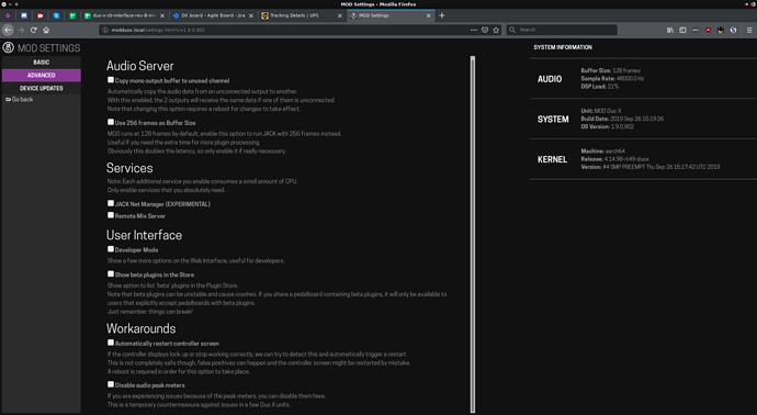

I still have the same issue, I just want to hear everything in stereo (just the same output in both ears) on my headphones.
I can get it to do proper stereo output if i have them going to the separate L and R outputs but i wont be running anything in stereo. So how can i hear the mono signal on both my headphones at the same time?
go to the gui settings (button on bottom-right), click advanced tab and enable the “copy mono buffers” option.
You need to look for this:
Thanks mate.
