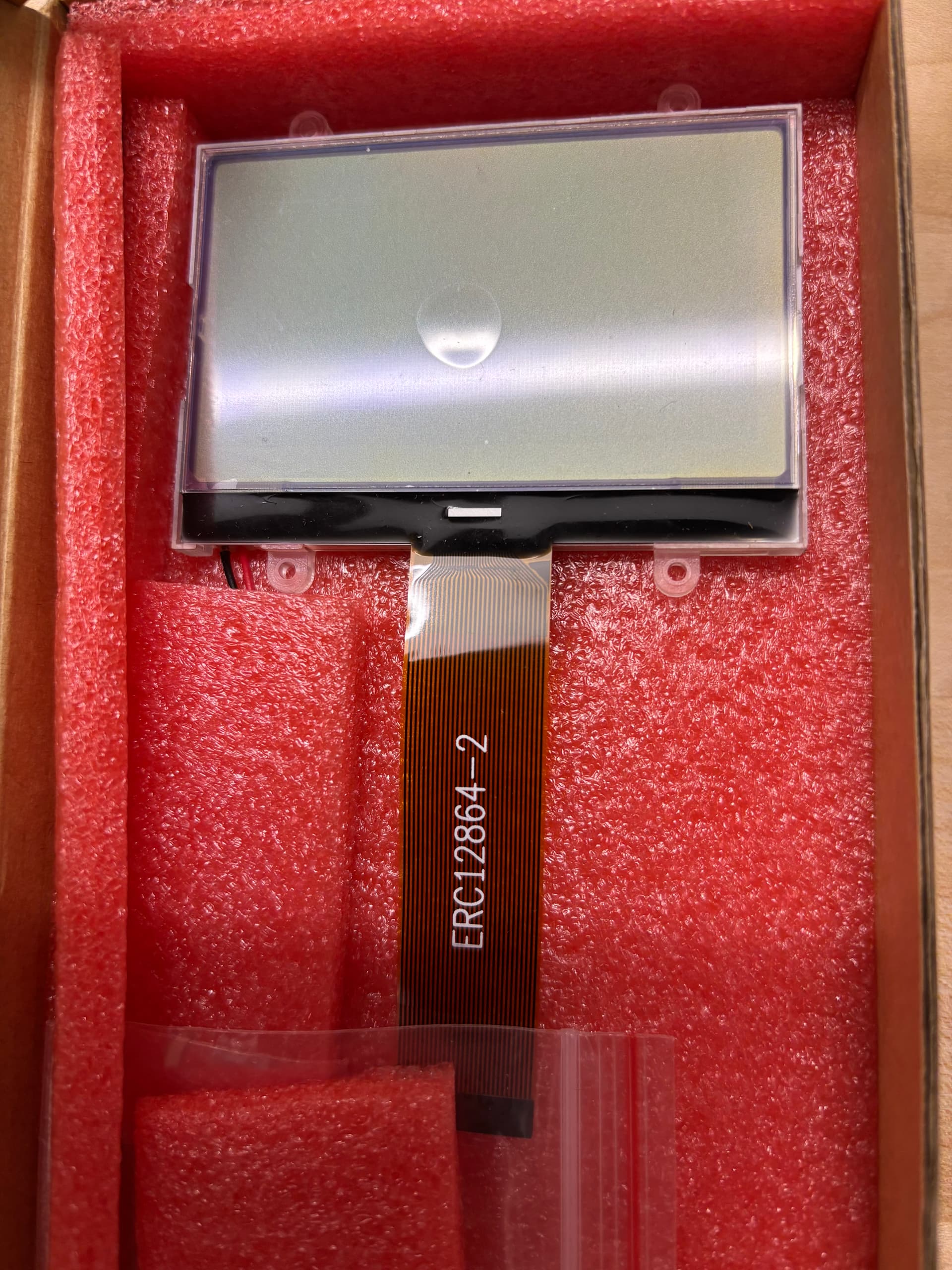

Yes, had to do it a few years ago. It’s not that hard if you aren’t afraid of unscrewing a few screws and exchanging a ribbon cable. I even got one spare display lying around. If i find it I can tell you the exact spare you need to order.
man, thank you so much! can I just replace the lcd? not doing driver tweaks and sorta difficult things?

please share it when you have a chance to look at! thank you so much Charly
man!!! OTL thank you so much!!
this is the real power of collective intelligence!! many thanks Charly!!
I replaced mine a few years ago, so my memories are a little foggy, but as far as I remember you have to open the case, remove some of the circuit boards and fiddle with the cables, but no need for any soldering or firmware stuff. The second display is still working, is it?
yeah! just left one’s broken. not completely but partially visible
Ah good, that’s exactly the same as it was with mine.
I’d say just give it a try, if you’re stuck somewhere you can always ask here.
Take a few photos when you open it and before unplugging anything. Just to be sure.
thanks man!
