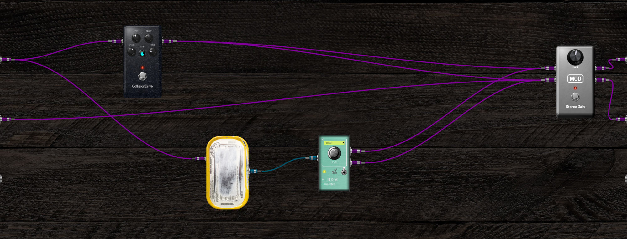

I use MOD Desktop mainly on Linux and added several plugins built by mod-plugin-builder.
I want to use this Audio2MIDI pedalboard but GxTuner doesn’t produce MIDI signals.
I use GxTuner version 43.0 which doesn’t generate MIDI signals.
My MOD Dwarf’s version is 43.0-24 which sends MIDI signals.
Can I find the source code of version 43.0-24 on the Internet to build by mod-plugin-builder?
