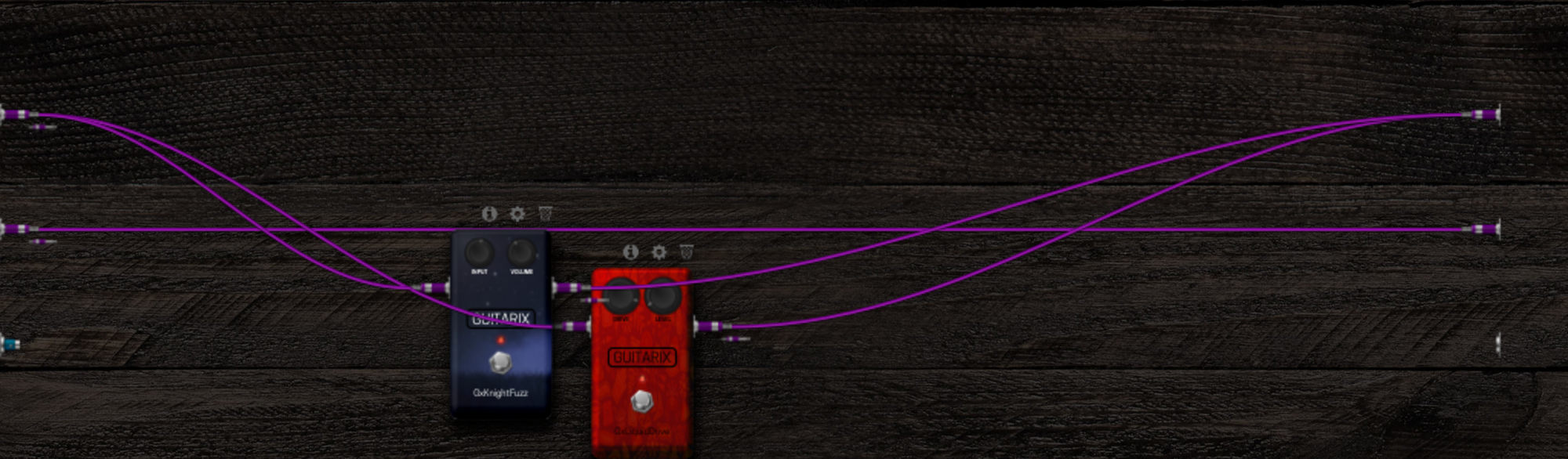

Here is a example of GxKnightFuzz and GxLiquiddrive in use:
