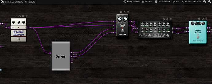

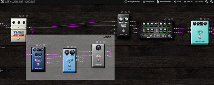

Not sure if this has been suggested before.
If there is a way to group a set of plugins in the GUI, maybe to be like a folder, and only show the plugins in the group when clicked on them, I feel can help to create a cleaner look on the GUI, especially when using a big number of plugins.
Will be great if the group or folder can be save as a preset of some sort, and is import into any of the other pedalboard with a simply drag and drop. Many time I will have to recreate a group of plugins exactly the same way in multiple pedalboards. This idea could save a lot of time I believe.
here is a very rough mock up of the grouping idea
