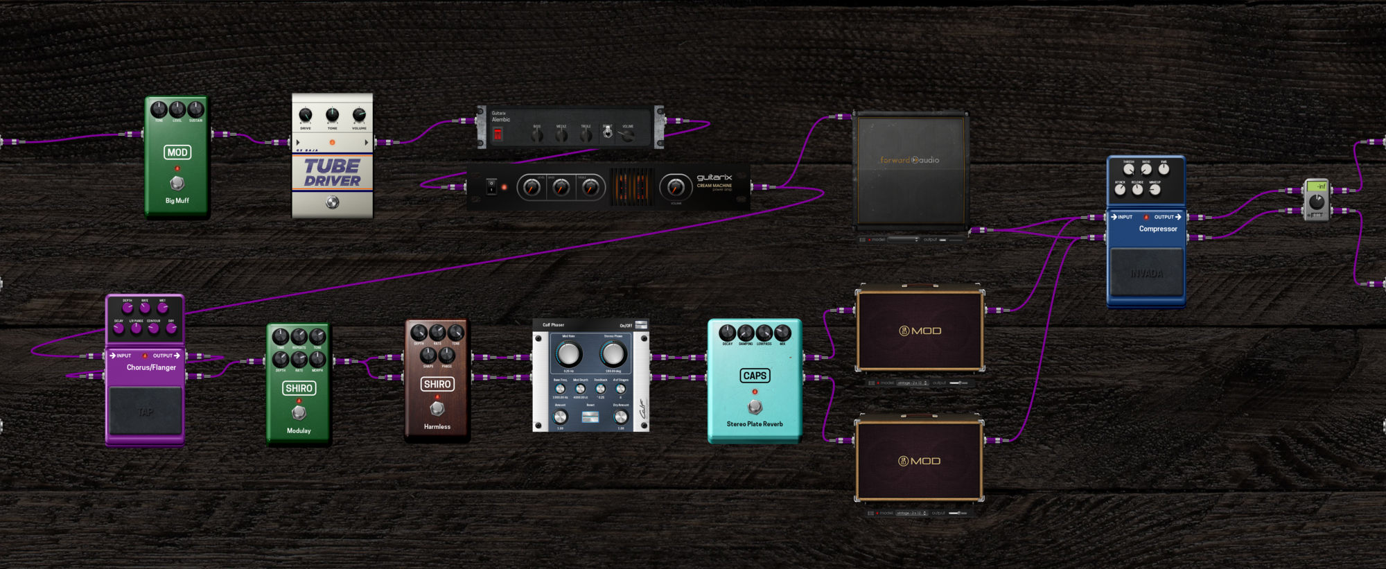

I like it but there’s an annoying issue that makes it unusable in live situation: when you play with snapshot 6. and then move to snapshot 7. there’s a “laser beam” sound (something like the ones in Flash Gordon soundtrack by Queen). I see the snapshot change has glitches like this here and there, I think it deserves more attention on bugfixing side.
Must be one of the plugins not correctly handling a specific change of parameters at once.
Loading snapshots by itself cannot cause this, it is always on plugin side.
Now we need to find who’s the bastard.
