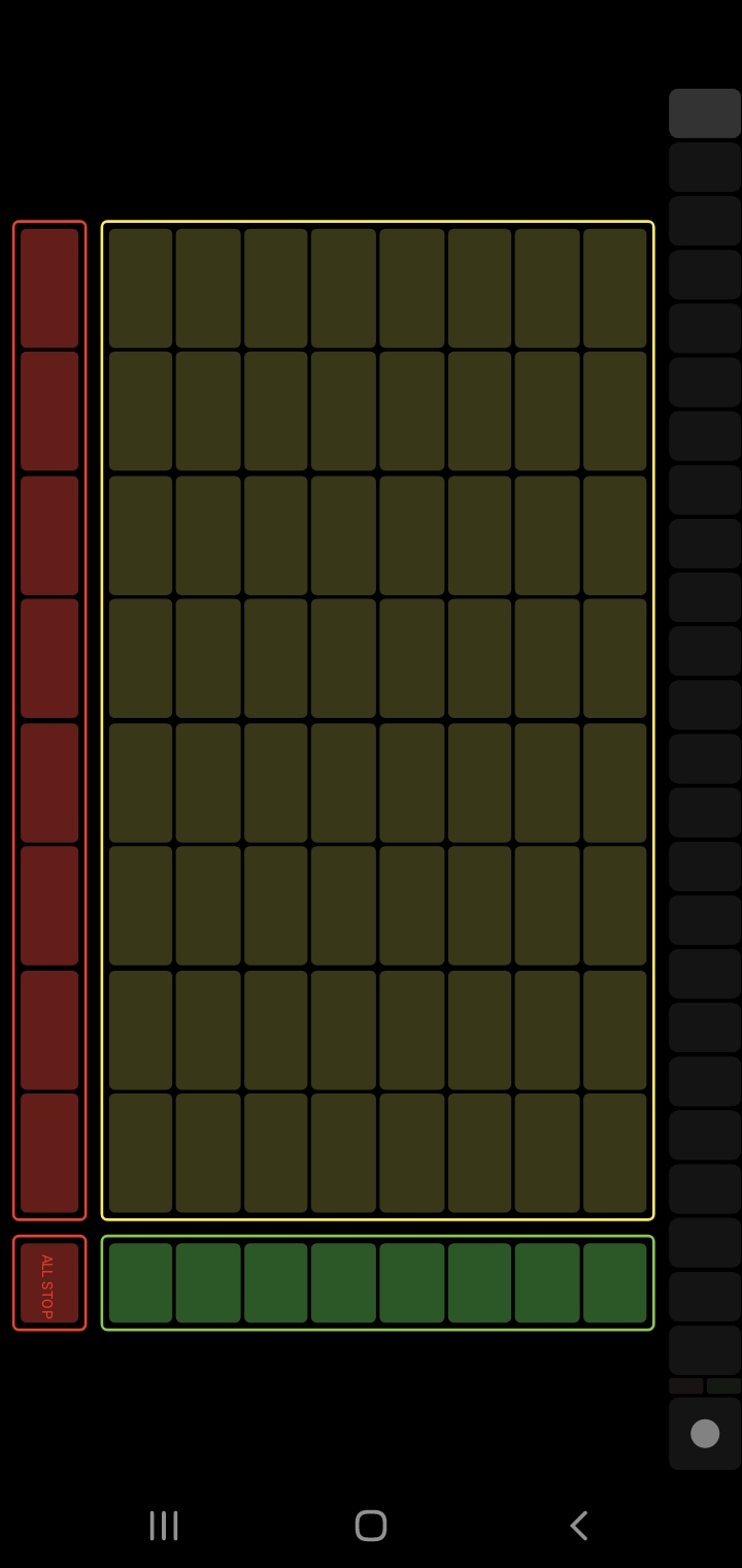

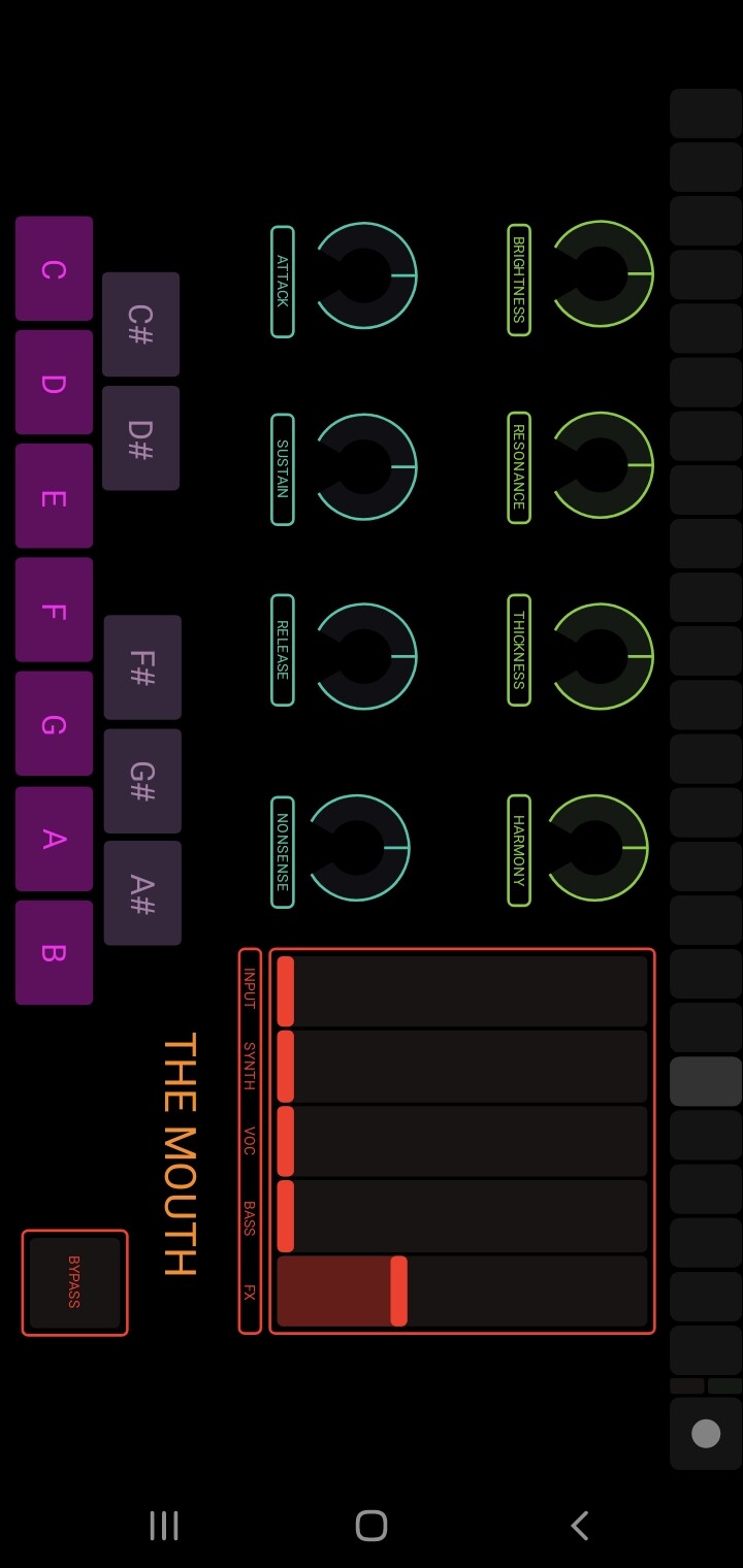

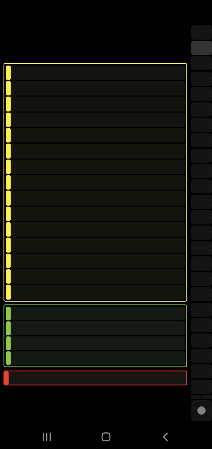

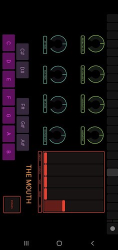

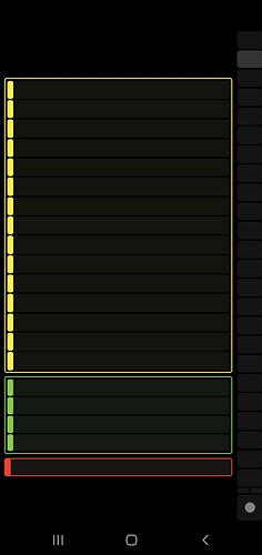

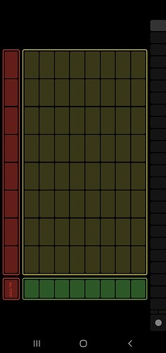

Just to give you some ideas on what you can do.
