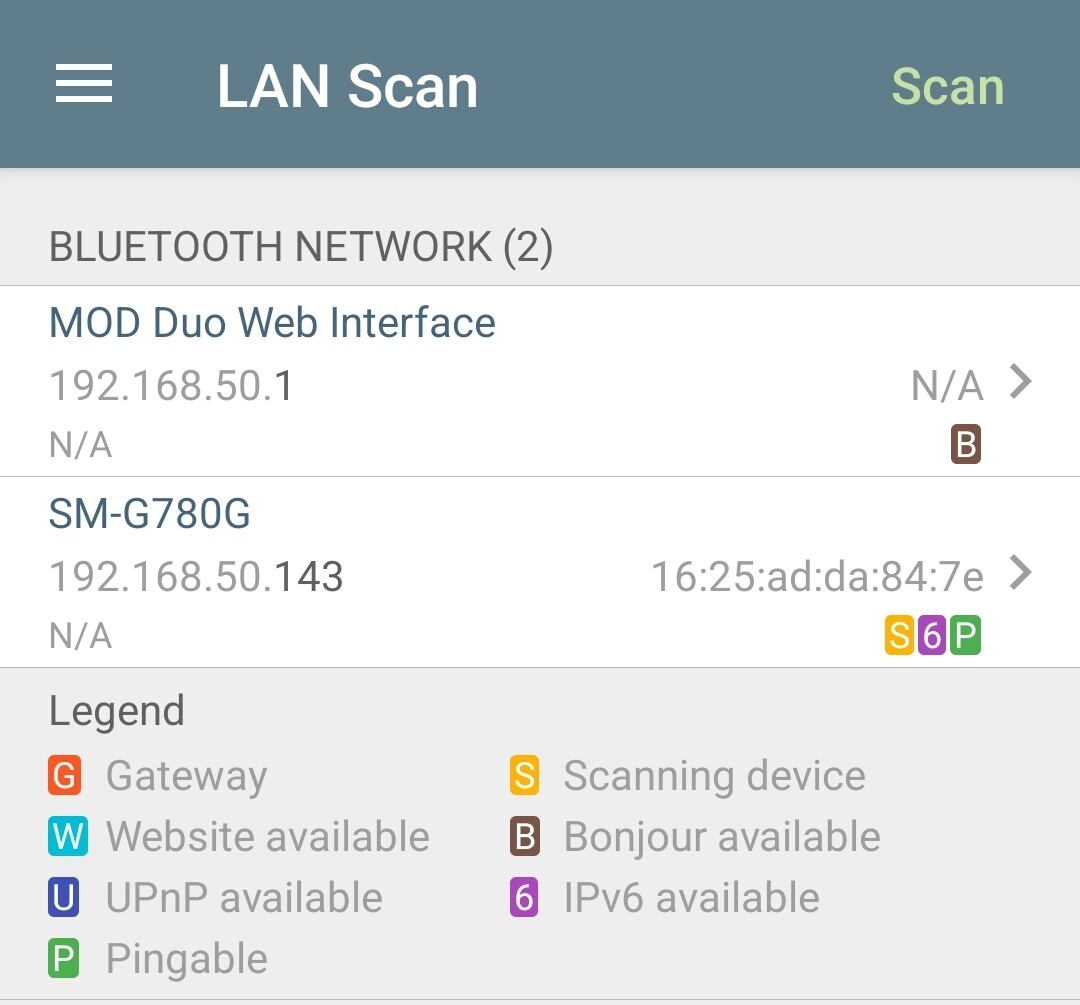

  • bluetooth on Android (it connects, but all that is supported is ‘Bonjour’, I can’t even ping the dwarf.

would you have an idea as why although the bluetooth connection happens, I am unable to even ping the dwarf?

The bluetooth status looks good: it goes from DISCOVERABLE to CONNECTED.
From my phone for instance, I can see the connection to the dwarf is done.
but then if I try to scan the ports, or even ping the dwarf, I hit a wall. (see my little picture in the first message from this thread)
