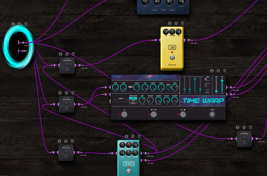

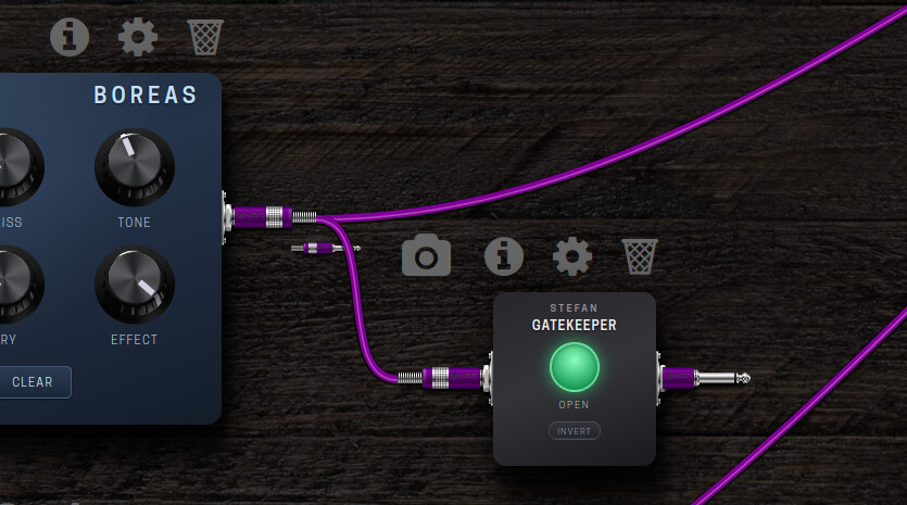

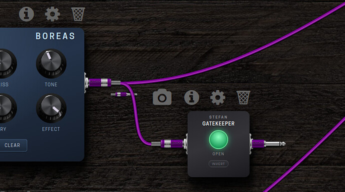

A while ago ( CPU usage on pedalboard and general advice - #2 by jon ) I asked if there is a plugin which can just cut off the sound and the solutions were not that satisfying to me so here is yet-another-llm-coded plugin!
By default if you add it into your chain it will not pass through any audio. If you press open it opens the “gates” with a super-fast fade to avoid clicks (you can control fade speed from the settings). But you can invert that behavior so default it’s passthrough and button-click closes the “gate”.
The point is that I can map my Dwarf switches to the “open” button so I can relabel them to the name of the following plugin and thus reduce noise by cutting off one of my parallel audio paths.
I made it as tiny as possible to not eat up too much UI real-estate.

indeed I am using it primarily with Portal to keep multiple parallel audio paths switchable on/off
