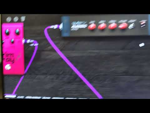

Can someone help me?
Certain plug-ins make very bad frying noise. It’s almost an amp simulation..
(The sound of the video was recorded low, sorry.)

In your video, I see that you are using the Alembic with a Bass cabinet. Does that mean that you are trying to get a Bass rig? Have you tried other cabinets?
I see as well that you have a Big Muff plugin on. Those are quite noisy indeed, but that’s just like the real thing. If you turn it off does the noise disappear while you are not playing?

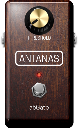

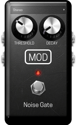

Try putting a noise gate early in your chain and see it blocks out noise below a certain treshold.
By changing the position of the gate, you might become somewhat wiser about the place in the chain where either the noise is generated or amplified (2 different things)
Noise gates you can check
