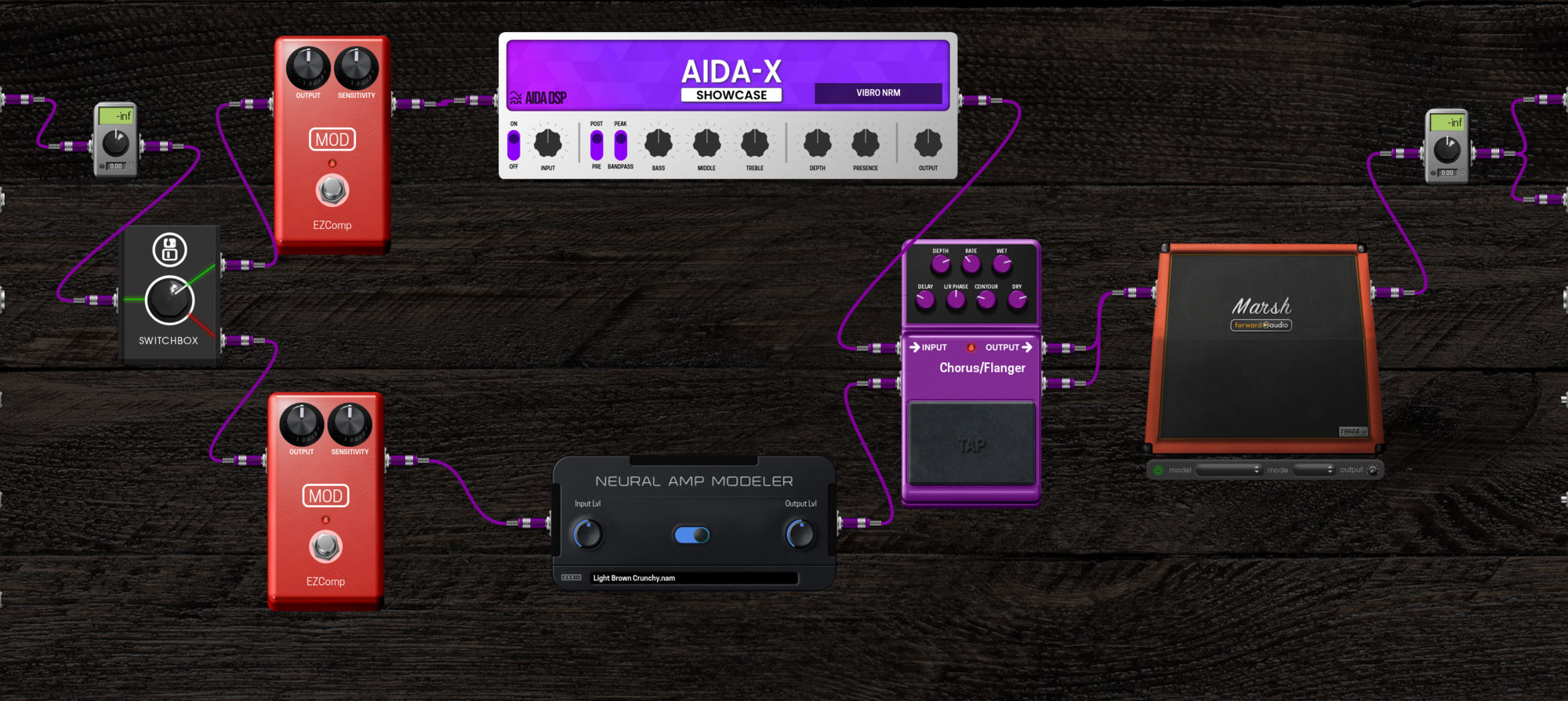

I just shared a pedalboard trying to match the tone of Frusciante’s guitar in RHCP song Under the Bridge. It’s a very simple chain but I never got it quite right with the previous gear I had. I also learned that the tone he uses is not as clean as I thought before! I’m pretty happy with it! I just wish I had a tenth of Frusciante’s skill and talent :roll_eyes:
It has two signal chains. One of them has a NAM profile (Marshall 2525H Mini Silver Jubilee) using the crunch model and the other uses the AIDA X JVCM Crunch so it’s usable if you can’t run regular NAM profiles :kissing_heart:. The chorus/flanger it’s set as default (I didn’t really bother to match that part and I think it sounds nice anyway).
I tried first to use an AIDA X model of the Silver Jubilee but it didn’t get me there :confused:
Glad to hear any comments or suggestions on how to improve it!

My Dwarf immediately goes to 100% CPU…
To much RHCP for the Dwarf?
Probably yes. Remove the path with the NAM plugin and see how it goes. :guitar:
I didn’t try your pedalboard yet, looking forward to doing it on the weekend! But maybe you could try to lower the cpu usage using this light aida-x capture of the mini jubilee that I captured myself with frusciante’s settings, give it a try! https://cloud.aida-x.cc/jotagenazar/640231a8-ef0c-40b8-af11-d3a678e02232
Thanks! Well, it has two signal chains with the purpose of deleting the heavy one if you’re using a dwarf.
I hope you like it when you try it! Let me know if it works better with your capture!
