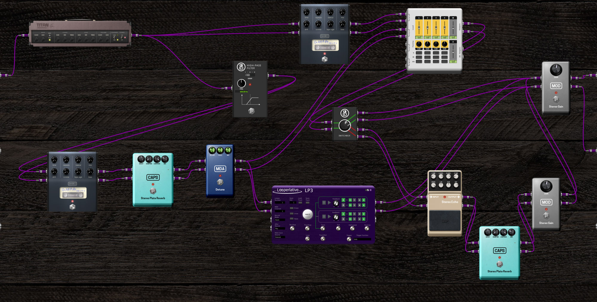

I shared it. It’s called 4 Rainy Day.
Cool !
Could you share the link so we can test it ?
Thanks @klowy ! I’ve saved it to my Dwarf and have cycled through loading it and about 5 other pedalboards for the last 20 minutes or so. Each time, I’ve been able to record. with the looper. There was one instance with your board that the Web GUI was unresponsive, but it came back after several seconds. That was only once out of about 10 different loads of the board. Also, your board seems load in under 10 seconds for me.
It took me 5 minutes to get it happen. I have a video. Let me know how to send it to you.
I don’t have a good way of sharing videos. I’ll DM you my email address.
