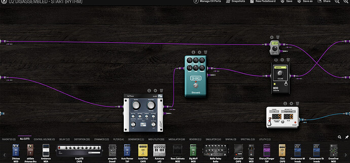

I had it a few times now that the Dwarf froze after I created new pedalboards and then switched to the navigation mode of the Dwarf after leaving the WebGui. Sometimes the display light has also gone out. After a reboot everything worked fine again.
I have a little feeling that it might have something to do with snapshots, because so far it only occurred when I created snapshots with the new pedalboard.
I proceeded as follows.
- Open existing pedalboard (which already contains Snapshot).
- Save under new name
- Create more snapshots
- Save again
- Exit Webgui
- Switch Dwarf to Navigation mode by pressing the two right footswitches
The pedalboard itself is not very complex (see screenshot)
