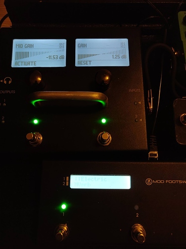

Here’s a view of my pedal board for reference:
As you can see, the main mod display is perfectly readable (brightness at 50%), but footswitch display is virtually impossible to read.
It’s made worse by the viewing angle on the displays - they are best viewed from beneath, and the contrast drops to zero quite fast when viewed from above. Unfortunately when this is mounted on a board in a live situation, I am almost always looking from that kind of angle, unless I step back from the board.
Perhaps there’s something wrong with my footswitch? Or is this how it is for everyone?
Mine looks the same.
