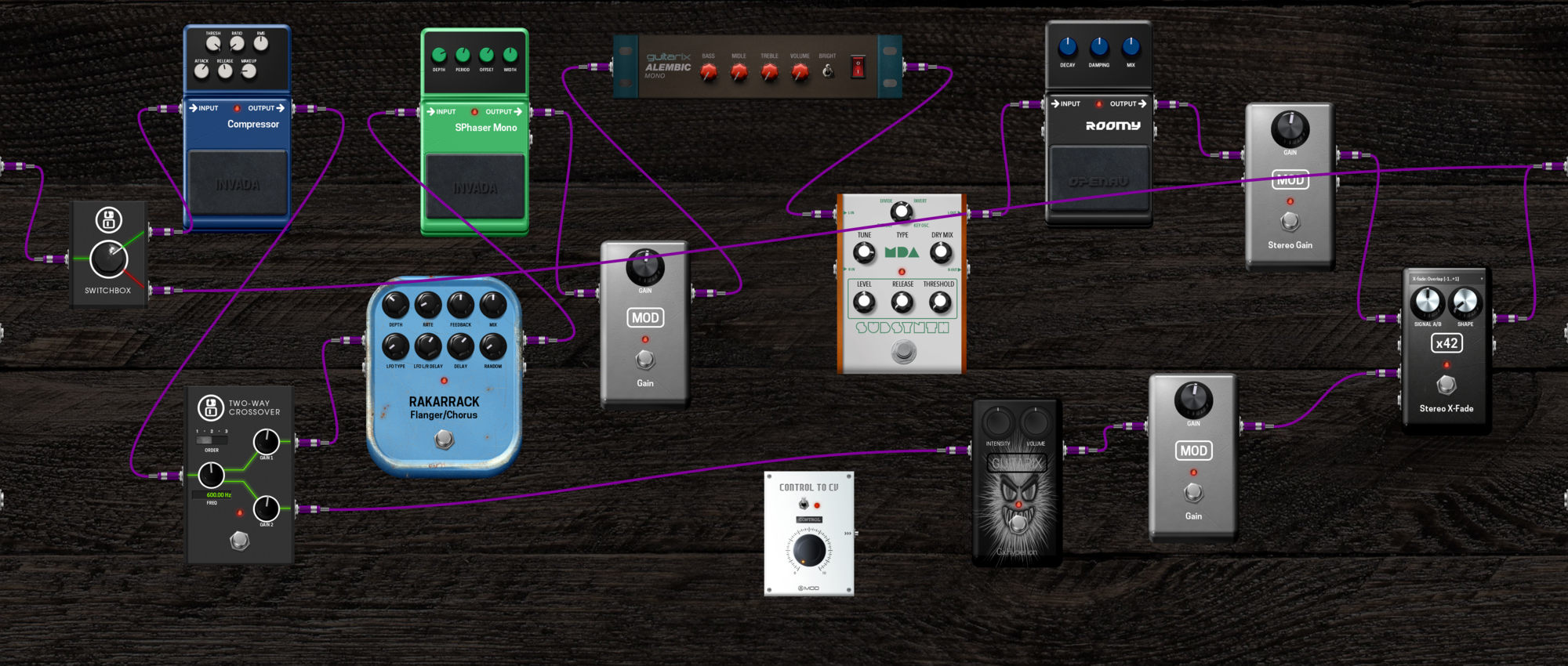

Here is my current board for trying and “studying”:
I normally play with a fairly clean tone, only compressor and a bit of reverb pretty much on all the time. Using the board, I can then easily add: chorus/flanger, phaser, boost/fuzz and octaver, and I have assigned knobs to tune those effects on the Dwarf. I have tried to get the same volume in all case, apart from the boost of course.
Note: the initial signal path switch is meant to provide a complete bypass option for the board.
Other note: I pretty much relied on my ears and what I liked to hear, and wasn’t too much worried on what the gospel is regarding where effects should go in the signal path.
Hopefully, this gives you some pointers and ideas for your own board.
Final note: the results are very dependant on the bass you actually play… this is kind of “optimized” for an active jazz bass. I also use an EQ pedal after the Dwarf to do any final adjustment (for example in a rehearsal or gig situation).

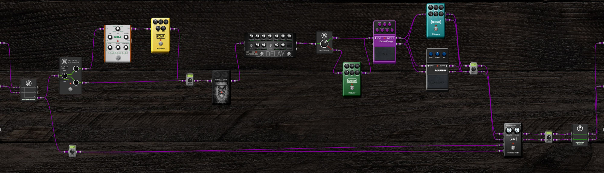

Nice to know that they helped, and thanks for sharing. My handle is pslh. My current board is PH Bass 231227 - MOD Audio (you need to enable Beta plugins in order to find it, since it uses the excellent Ztoggle4 plugin by @zwabo.
I sometimes use disabled TinyGain Mono - MOD Audio plugins to keep the cables tidy. I guess this might increase the CPU load slightly but has not been a problem for me so far. If anyone has a better idea for fixing cable positions, please do share.
