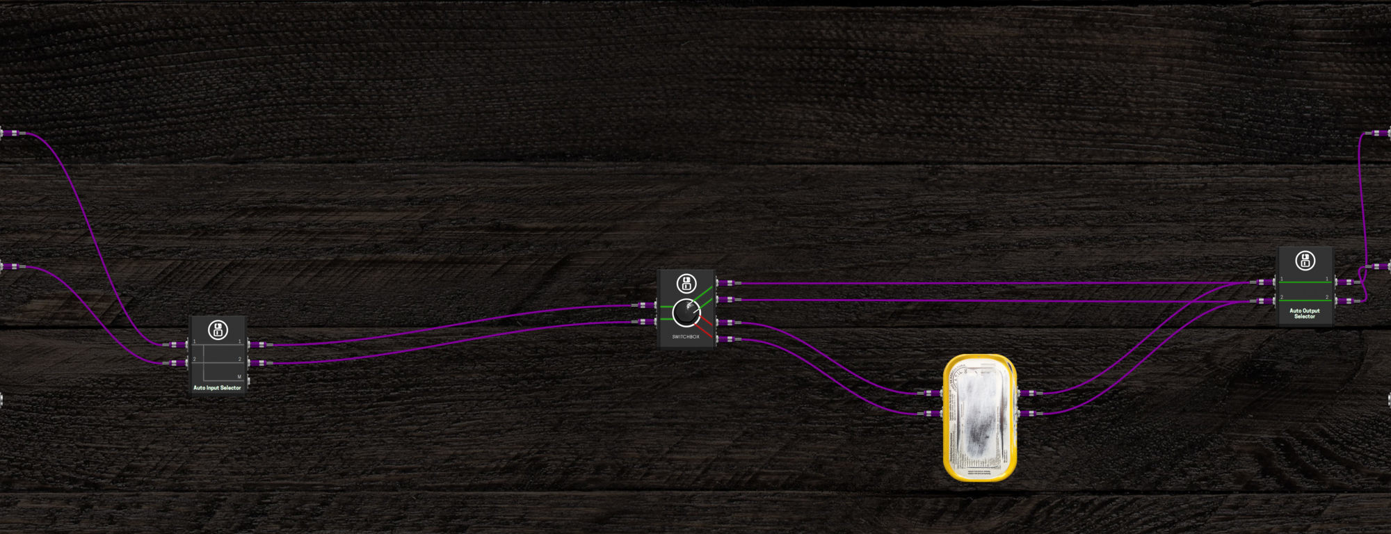

Couldn’t you build a trails feature by having dry and wet on two signal chains in mod and using a switchbox for blocking out the dry sound going into the wet chain?
Huh, ok, trying to wrap my brain around that one-- I’m currently using a cv switch w/attenuator to turn either galactic or gaffa on in my “ambient” chain, but not both… but why am I not just using a switchbox in that section in the first place and leaving them both on?? which would accomplish my goal of one on/one off with one switch assignment and also keep the reverb output going after I made the switch… Man sometimes I take the complicated and dumb route… ![]()
Thank you for the suggestion!
Yeah sure that would do same, basically letting the reverb trail ring out while routing your signal into the other reverb.
You mean like this ?
yep… I can only hope that the existence of this post helps someone else in addition to this particular doofus
Not sure, I’ve already shared this solution somewhere else in the forum, maybe without the good keywords ?
