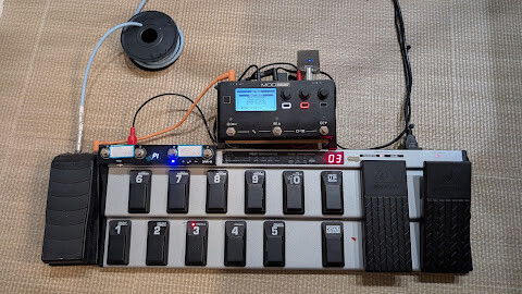

So, I have found a cheap second hand unit with a UnO chip and bought a license of the original Control SW, which luckily enough worked on my linux laptop with wine and my USB-Midi interface.
I like the “Stompbox” mode. It seems to fill (more or less) the gap between a control chain device and anormal midi controller which cannot show the plugin status
What it sucks:
  1. (but is more a MOD limit) is that if you assign one of the pedals to the volume you will end up having volume spikes changing snapshot. It would be great (has already been asked more than once) to be able to have “global” controls not impacted by snapshots. Until then an analog volume pedal will fit better…
  2. you cannot define a default setting after power up…
  3. other will come
Anyway, with some programming, 3d printing a support for the dwarf, after some cable management (more will come) and some velcro this is my setup. I am quite happy with it.
Sooner or later i will mod it to use the same 5V USB power source I use for the DWARF and possibly buy a “UnO2” chip which is far more flexible, or i will put an esp32 with the PedalinoMini FW.
