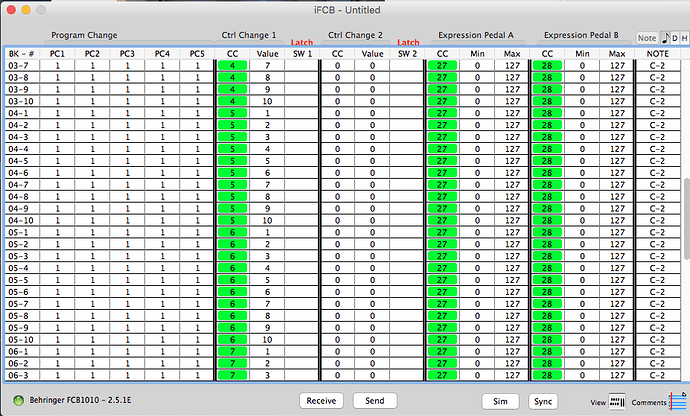

When I first tried using the FCB with Mainstage, I had a bad experience because Mainstage didn’t seem to be able to recognize or differentiate between the codes that were being sent per button. My resolution was to spend $20 on a nice little tool called [iFCB(http://www.wabbitwanch.com/iFCB.html).
The iFCB tool lets you reprogram everything in a graphical interface - much saner than trying to it directly on the FCB I’d guess. With that I assigned a nice linear progression of (CC, value) to each bank of buttons (the middle column):
WIth a configuration like this, the “learn” functions of the few apps I’ve tried have worked well. Unfortunately iFCB is OSX only, and I haven’t looked for other tools. With the relatively popularity of the FCB1010 in these communities it would be nice to have an open source, cross-platform tool for doing re-programs of the device, especially if it included a few sane default templates.
