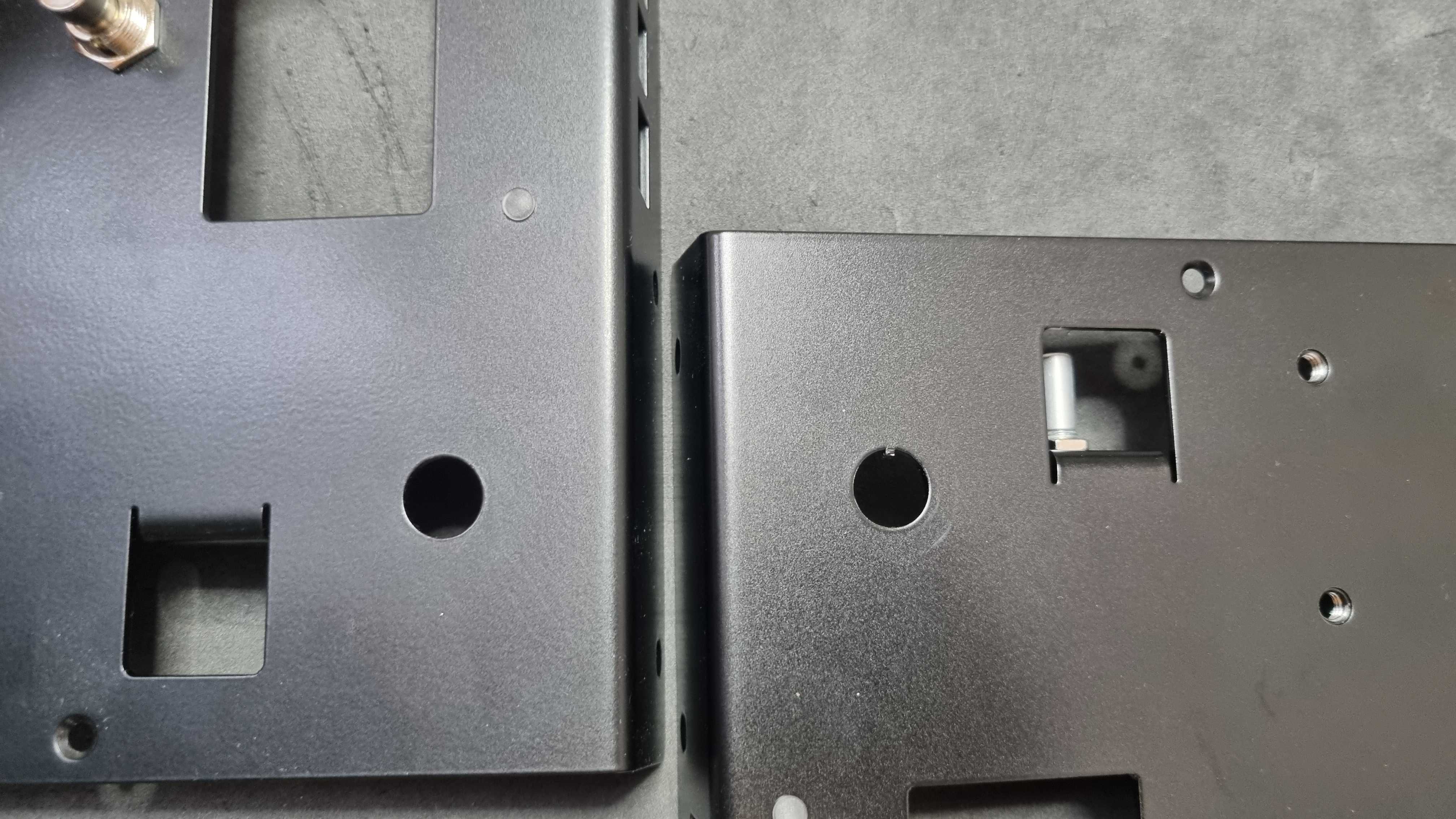

I forgot to make an update when the new parts arrived so here it is.

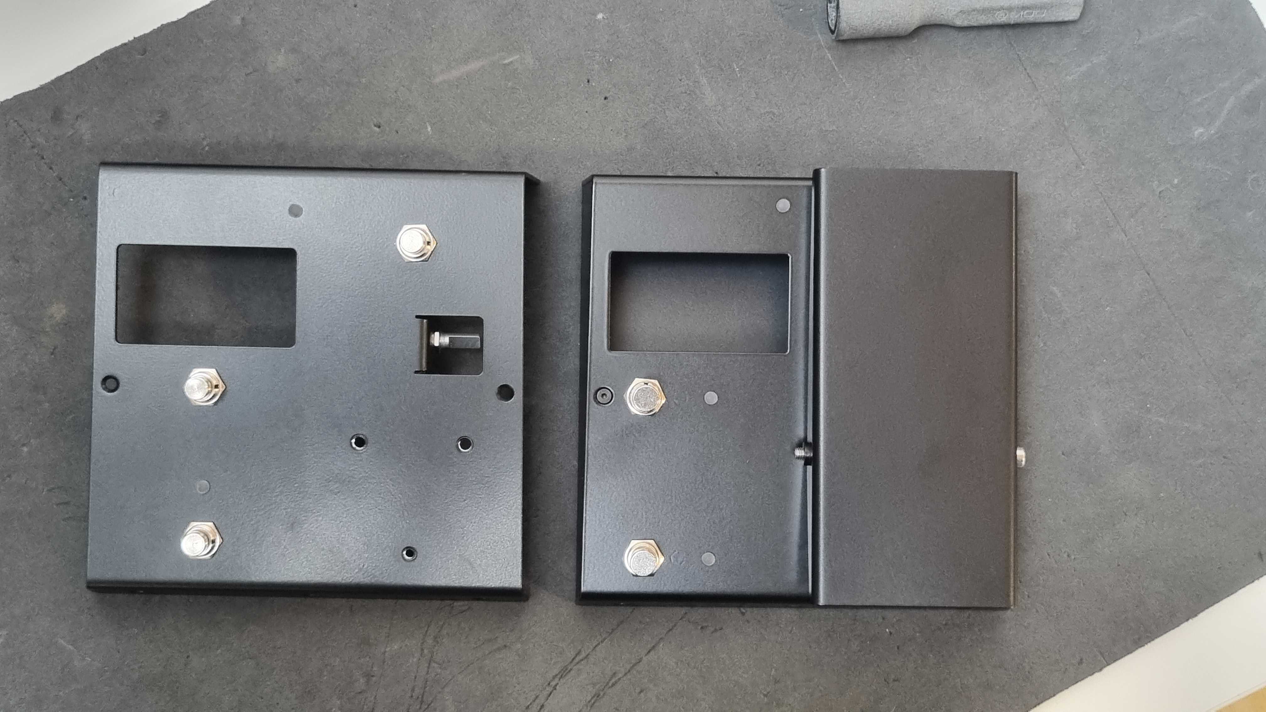

The one on the right is the latest. We moved the footswitches over to the left so that there is enough space between them and the pedal so that your foot doesn’t get blocked. We also added an LED for the pagination button

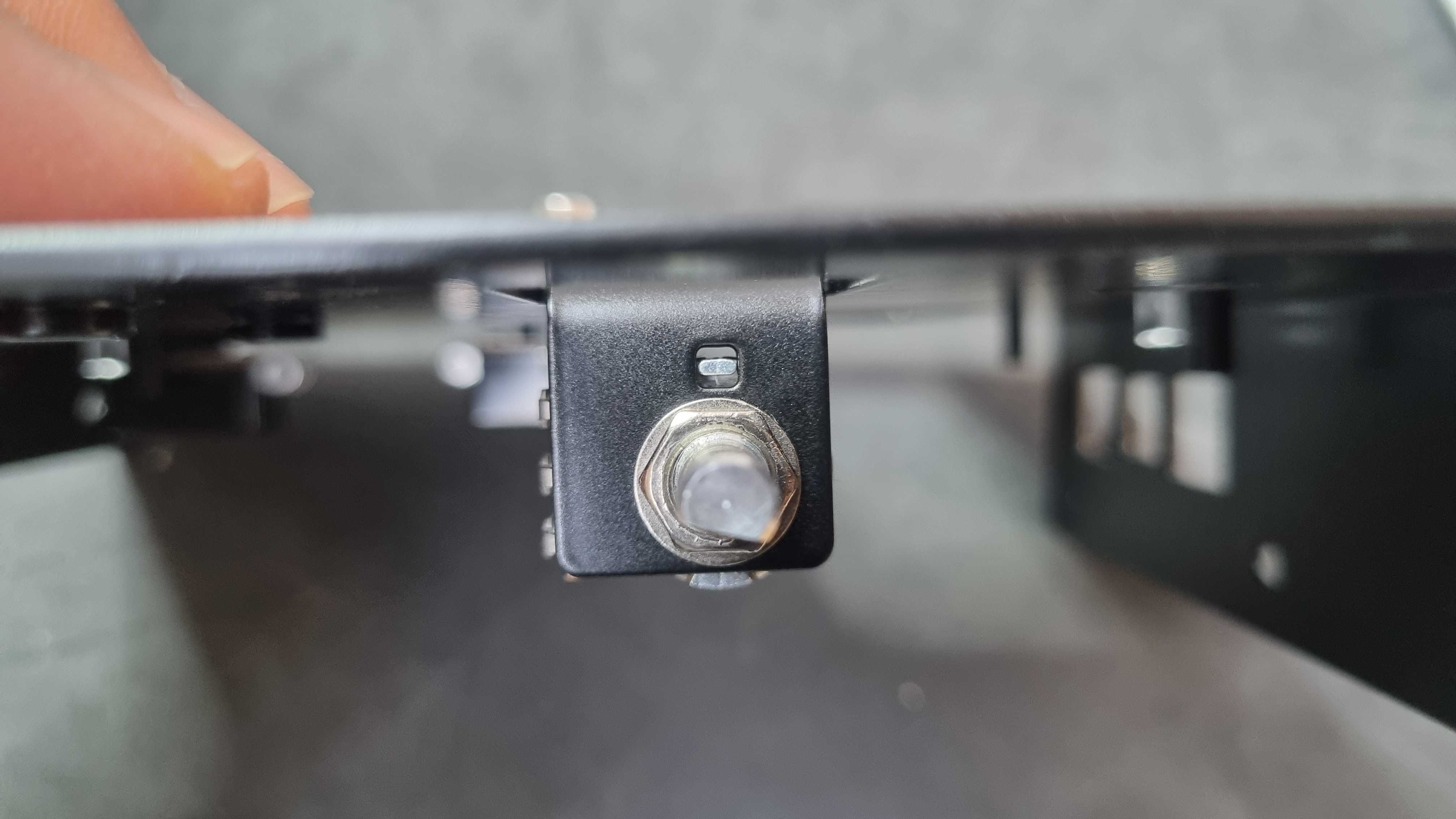

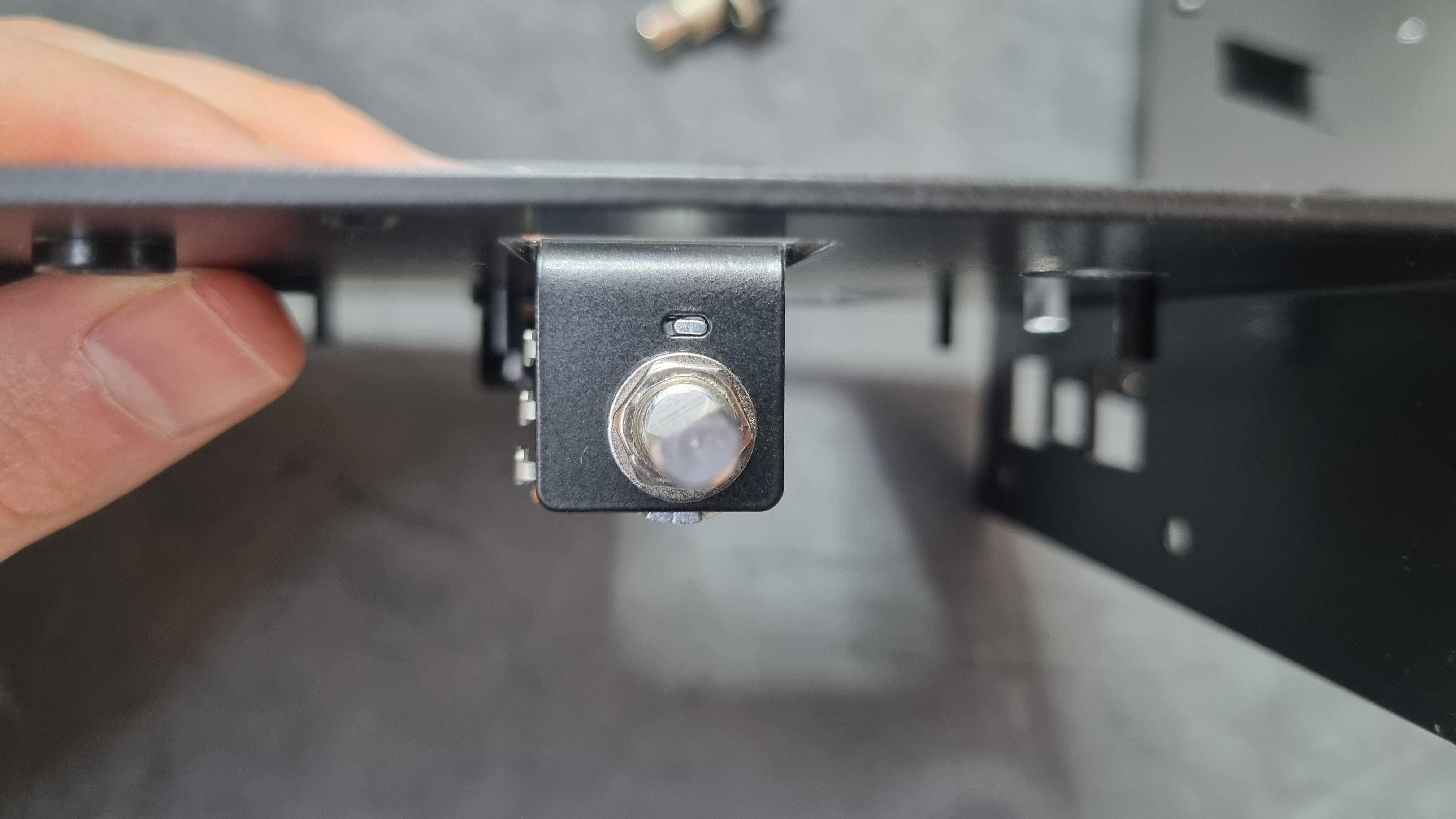

I added some locator tabs to keep the footswitch from rotating while assembling

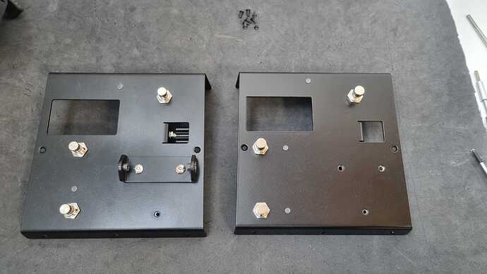

This locator hole only allowed for one brand of potentiometer
So I extended it vertically to allow for different models while still restricting rotation

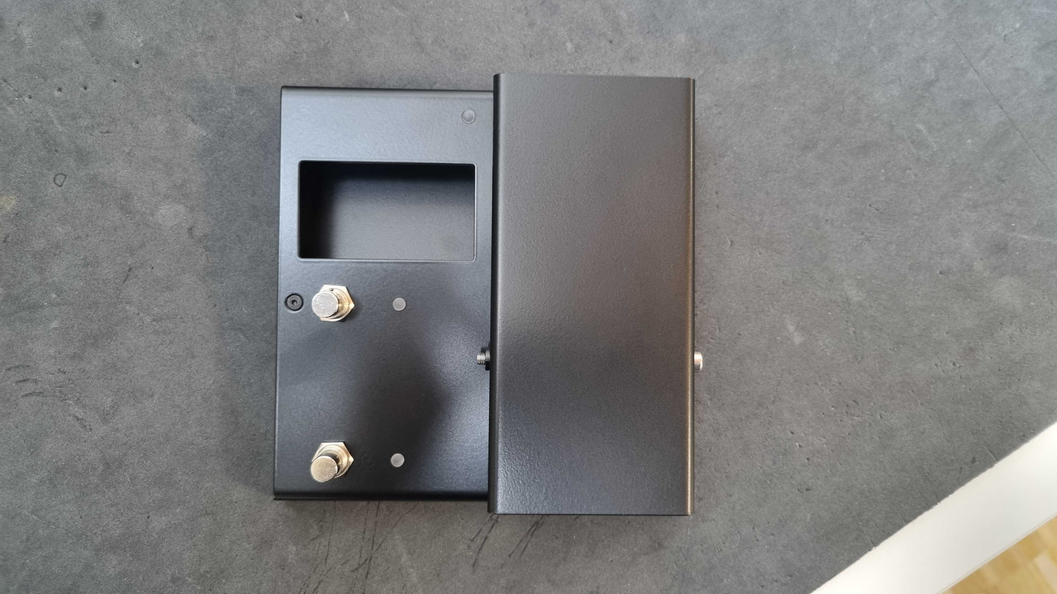

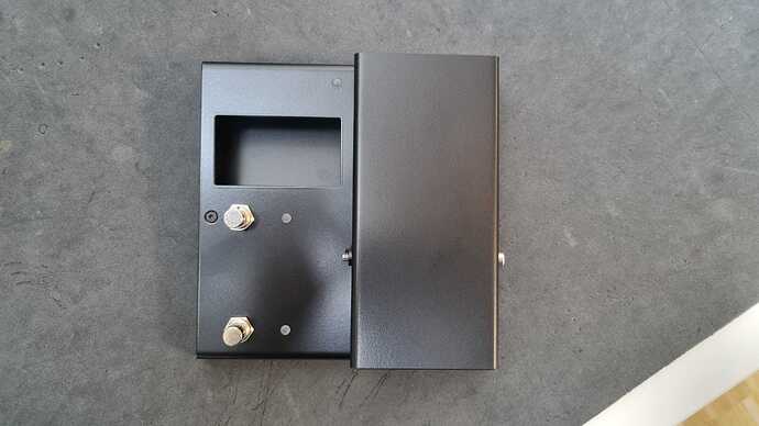

Here’s how it looks with the pedal on. There will also be grip on the pedal. Likely PVC grip tape
Another side by side of the changes

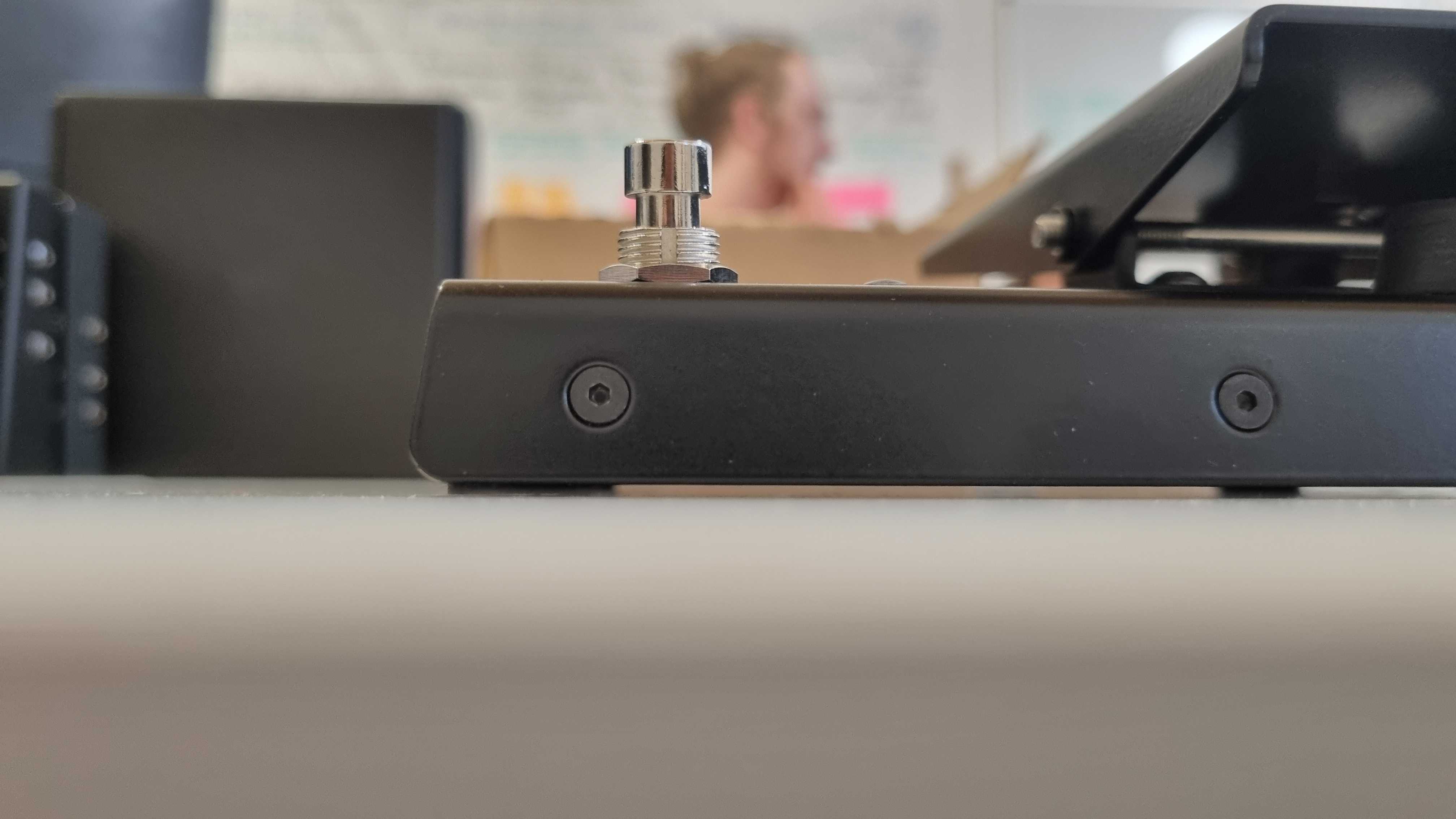

This was to show that there is still plenty of support underneath to the left of the footswitch so it will not flip when you press it. ft. @jesse’s head
